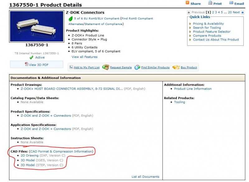

Deutsch does offer CVM or CAD models of some of their connectors. Unfortunately you have to search their website using a part number which will open a Part Detail Page. CAD models will be found under the Documentation & Additional Information section of the page. I think if the OP were using Deutsch connectors exclusively then it would be well worth the effort to contact the company directly and ask if they offer DWG files that could be used in conjunction with AutoCAD Electrical.
I found another way to search by browsing a catalog. A couple of clicks later and here is a reference to CAD files. It would be nice if they had a way to download an entire library.

  ReMark said:
[ATTACH=CONFIG]46060[/ATTACH]

Thank God, Tyco Electronics bought Deutsch Conectors and can download the. IGS very easy, as demonstrated ReMark.
