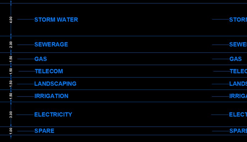

Offset lines create diffrent layers and specify offset distence
1. In utilities need offset the line 2m. and 1.5m and 4m….etc.
Every line create the new layer (new layer name user defined ) no need color.
2. the layer name I defined as the line type
Example:- layer name: MV Electrical (---MV Electrical---MV Electrical---MV Electrical---MV Electrical---)
And how much distance between the text also user defined
No need line between text to text
Thanks
I am sorry for my poor English

Please post a example dwg or image.
To have different spacing of the text would mean that it is not a line type but text and lines, you can though create the smae linetype many times with different text spacing.

my request specify which side offset and continue this lisp when i press Esc.
another one is line type
Your welcome,
But I didn't get what you said next, what you want to do exactly....specify clearly or give example

example:- when i offset line
layer name:- TELECOM
so my line type in layer also telecom its possible or not
