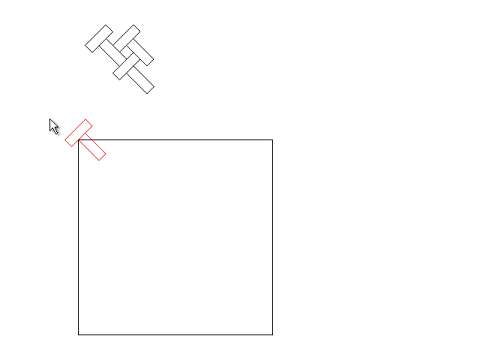

Jerome2013 Posted December 3, 2013 Posted December 3, 2013 I just want to know the steps how to do this (referred to attached file). I got dizzy :ouch: Quote
MSasu Posted December 3, 2013 Posted December 3, 2013 Use the RECTANGLE command to draw the contour (please check on Tutorial section for coordinates input). Next call HATCH to fill it. However, I'm not sure if that hatch pattern is shipped by default with AutoCAD. Quote
eldon Posted December 3, 2013 Posted December 3, 2013 I think that that pattern was done by offsetting lines, and trimming out the bits that were not needed. There is an anomaly in the pattern that would not be drawn if a hatch pattern were to be used. For those without too much to do, hunt the anomaly Quote

steven-g Posted December 3, 2013 Posted December 3, 2013 I think the anomaly is more of an error or 3 (could be wrong). Anyhow's here is a hatch pattern to try. Change the extension to .pat and drop it in the hatch pattern folder weave45.txt Quote

eldon Posted December 3, 2013 Posted December 3, 2013 However, what would be clever and show a bit of thought is to isolate the repeating pattern, make a block of it and then to multiple copy or array that to fill in the area. Quote

Barneel Posted December 3, 2013 Posted December 3, 2013 Seems like such an excessive offsetting and trimming exercise, lol. That's gunna take days. I guess the most basic way of doing it would be to use the RECTANGLE > specify first point > DIM > 200 > 200 Then draw a set of vertical LINEs at spacings of 10, and once you've got enough to fill the box ROTATE 45 degrees and align as per the drawing (note that there is a line going directly from corner to corner). Once aligned, select all your lines and use MIRROR, selecting the midpoint of the top and bottom lines of your rectangle as the mirror line and selecting NO when prompted to erase source objects. Now you have your base its time to get trimmin'. First you'll want to get rid of all the outer lines so I'd just select the rectangle, type TRIM and then select all the lines around the outside of the rectangle to trim them. Once you've done that select all the lines within the rectangle and TRIM them as per the drawing you've been given by just clicking on the parts of the lines you want erasing. Note: Its possible to skip the first few of steps and get by using a HATCH pattern on the 200x200 rectangle to get your grid. But this is probably the most fundamental way of doing it. If you need any of this in more detail, or if something is unclear just let us know. Quote
nestly Posted December 3, 2013 Posted December 3, 2013 "Weave" hatch would be the most efficient if you have it, otherwise it's a pretty simple array. Quote
