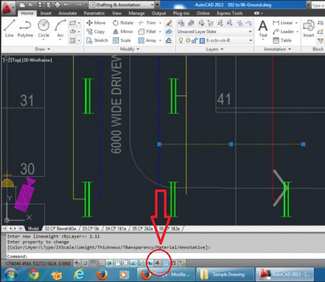

Want to ask how can i make that yellow line become thicker ?! I already made the lineweight to 2.11mm but it still can't change to thicker (sorry for my bad english)
Based on your screenshot, it appears you have Lineweight display disabled.
Whether it shows on the screen or not, it will plot at your width.
When you enable lineweight display, it is still not an accurate picture of how wide the line is. The displayed lineweights on the screen are merely a differential representation of the fact that some lines are wider than others. You can control how much the lineweight differential shows on your display by going to Options >> User Preferences tab >> Lineweight Settings button >> Adjust Display Scale slide switch.
