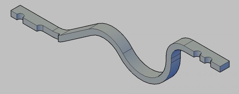

ReMark Posted November 27, 2013 Posted November 27, 2013 Very nice Solidworks drawing (someday I have to learn that program) however I thought we were talking about AutoCAD? The basic steps I took were: Create regions. Do subtractions where necessary. Rotate side view. Extrude each view so they intersect. Used the Interfere command to obtain the (almost) complete object. Realize the two holes are missing because the object is bent. Locate circles for holes on new 3D solid object. Used the PressPull command to create the holes. Done. Quote
ReMark Posted November 27, 2013 Posted November 27, 2013 Side and top views after being extruded and the Interfere command is run. That red part in red is your 3D strap. Quote
