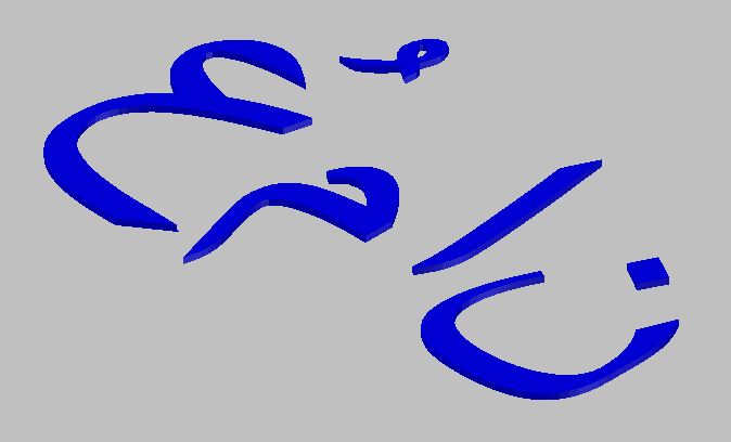

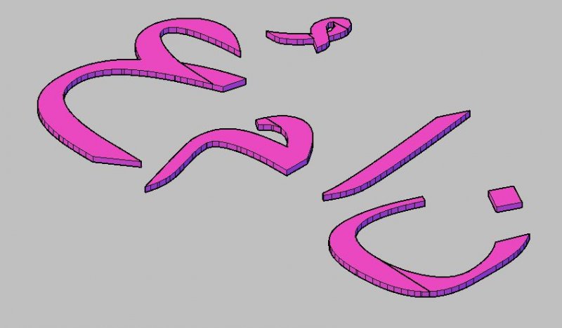

MSasu Posted November 28, 2013 Posted November 28, 2013 The tools suggested above is in fact converting a text entity to a set of closed polylines resembling the original letters. It just automate the process of exporting the label in WMF format and importing it back into AutoCAD. The only setback is that a letter may be formed by more than one closed contour. From the screen-shots posted by ReMark the appearance of the label seems to be preserved. Can you please post a set of before/after screen shots to allow us to understand your issue? Quote
ReMark Posted November 28, 2013 Posted November 28, 2013 When your text is exploded you will find that some (not all) of the letters are made up of multiple regions. That's OK. Extrude the regions 30mm. When done union the regions to achieve a single entity. The lines between regions will disappear. The first image I posted showed your text BEFORE I used the union command. The second image (in blue) is AFTER the union command is used. You should have been able to explode, extrude, union, group and scale the text in five minutes or less. You're making this more difficult than it really needs to be. Stop over thinking the task. Quote

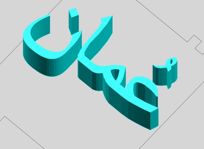

ReMark Posted November 28, 2013 Posted November 28, 2013 Yes, I see the problem. What can I say? I'm an English speaking/writing person. The nuances of the Arabic language escape me. It looks like it might be possible to reassemble the exploded version into something that comes close to the original but it will take some work. Have you tried to do that? Quote
wanted90 Posted November 28, 2013 Author Posted November 28, 2013 Hi Remark .. you did the text as I want ..^_^ but how you did that please tell me ! I am sorry I am weak in English Can please explain that with easy words . Quote
