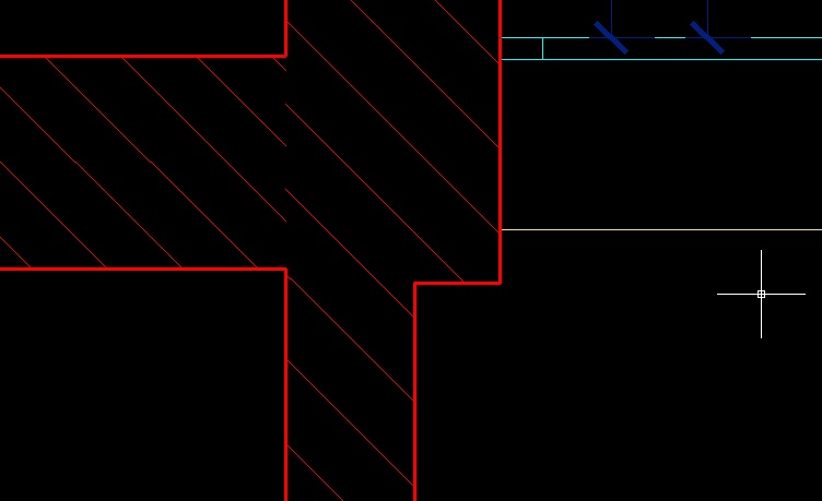

igreere Posted November 26, 2013 Posted November 26, 2013 Hello. I have the following issue with hatching. How can I solve it? Thank you. Quote
ReMark Posted November 26, 2013 Posted November 26, 2013 Erase what's there and redo the hatch? There is one other option (if I am understanding your question correctly) and that would be to find and use the Merge Hatch lisp routine. Quote
igreere Posted November 26, 2013 Author Posted November 26, 2013 I usually erase and hatch again, but I was wondering if there is any other choice. I am a bit lost with the MERGE HATCH. I read it's shortcut is MH, but apparently not for 2010, where it says unknown command. Quote
MSasu Posted November 26, 2013 Posted November 26, 2013 Alternatively may edit those two hatches and make sure that have identical Origin Point. Quote
igreere Posted November 26, 2013 Author Posted November 26, 2013 I was also thinking of the origin point. But for both hatches the origin X and origin Y are set to 0. Quote
Dana W Posted November 26, 2013 Posted November 26, 2013 I was also thinking of the origin point. But for both hatches the origin X and origin Y are set to 0. In the hatch edit dialog you can select a new origin point. Any corner of that wall structure will do. It will not merge the two hatches, but they will align and appear to be merged. Select the same point for each hatch. Edit the hatches one at a time. The Merge hatch routine is a lisp program. You will have to download it to your computer, load it to your AutoCad program, and then run it with whatever command it wants to be executed by. Quote
igreere Posted November 26, 2013 Author Posted November 26, 2013 Thank you. I edited the hatches and it looks fine now. Do you happen to know where I can download the lisp from? Quote
Dana W Posted November 26, 2013 Posted November 26, 2013 Thank you. I edited the hatches and it looks fine now. Do you happen to know where I can download the lisp from?You can try here, Cadalyst or google Merge Hatch. Quote
