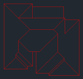

Tuns Posted November 25, 2013 Posted November 25, 2013 Here is the house he is drawing from the back view. The back side of the roof is straight across and doesn't have that indent. Quote
eldon Posted November 25, 2013 Posted November 25, 2013 I think that picture was created rather than drawn accurately. Lets await the OP's thoughts. Quote
Tuns Posted November 25, 2013 Posted November 25, 2013 Agreed. I was simply basing my opinion on the assumption that the artistic rendition is accurate. Quote
steven-g Posted November 25, 2013 Posted November 25, 2013 The drawing supplied by the OP is slightly different to the artistic renders anyway. Quote

Dana W Posted November 25, 2013 Posted November 25, 2013 Once I looked at all the renders, I saw how wrong the OP's plan view is. Going by the OP's plan, I came up with exactly the same thing as Eldon and steven. The main roof at the facia should be about 4 feet higher than all the other side hips, and is visually separate from all the rest, at least around most of the perimeter. The OP's plan does not account for the differences in this height. Another word of recommendation to the OP; Your roof pitch as you mentioned early on is at 45 deg, or 12 in 12. This pitch is going to result in a roof ridge on your main roof at about 20 feet above the ceiling. You just don't want to do that. That is more than double the height of the house walls above ground. I suggest a pitch of no more than 5 inches of rise in 12 inches of run. that will get you much more pleasing visual proportions. In order to draw this roof in plan view, the section of the house under the elevated main roof section needs to be discovered. Then draw a basic hip roof section over that. Next all the side hips can be drawn to intersect the man roof. Then trim out or modify all the lines that get covered up. Quote

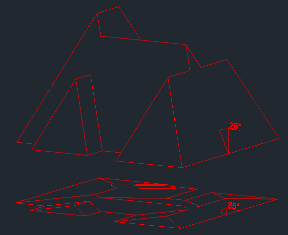

steven-g Posted November 26, 2013 Posted November 26, 2013 The plan drawn is the same for any pitch of roof, providing the pitch is the same for all surfaces, the attached image has very different pitches but the plan doesn't change. Quote
Dana W Posted November 26, 2013 Posted November 26, 2013 steven-g said: The plan drawn is the same for any pitch of roof, providing the pitch is the same for all surfaces, the attached image has very different pitches but the plan doesn't change.That's right, the only thing that does change is the ugly factor of the elevations. As far as extreme roof pitches go, more often than not predominant weather factors come into play, eg. wind, water, and snow loading. Quote
Dana W Posted November 26, 2013 Posted November 26, 2013 Of course, the OP does not have to do the roof exactly like it is shown in the renders. The ceilings can all be at the same height, as well as all the perimeter roof facia lines. In that case, Eldon's and Steven's solutions will suffice. Quote

steven-g Posted November 26, 2013 Posted November 26, 2013 What you have drawn is physically impossible to build. Nothing to do with artistic impression. It is just plain wrong. I'll try and draw the building as shown on the photos, to try and explain. Quote

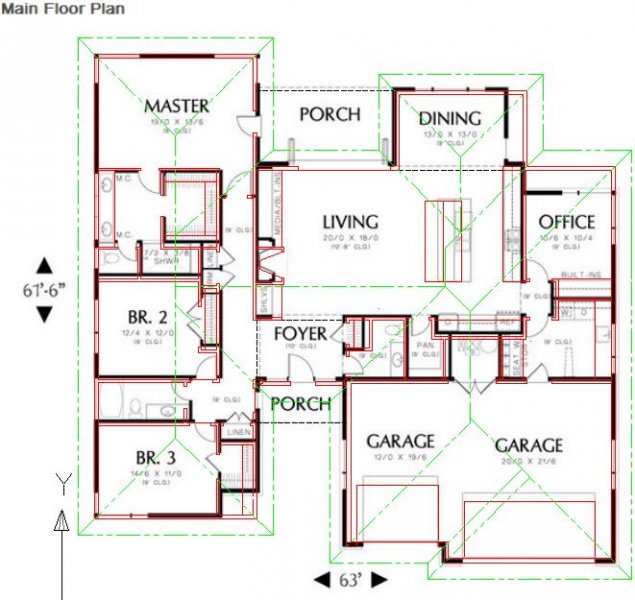

eldon Posted November 26, 2013 Posted November 26, 2013 If you look at the floor plan that the photos are based on, the OP did not even get that correct. So how can anyone draw the roof when the floor plans are wrong? Quote
ReMark Posted November 26, 2013 Posted November 26, 2013 Of course the floor plans are wrong. Everyone knows those layouts are just pretty pictures and any resemblance of the dimensions to reality is purely accidental. Cold hearted orb that rules the night, Removes the colours from our sight, Red is gray and yellow white, But we decide which is right. And which is an illusion? Days of Future Passed - The Moody Blues Quote
eldon Posted November 26, 2013 Posted November 26, 2013 Out of the OP's mouth Quote We had to copy out the floor plan from a house we found & add the roofplan. I chose this floor plan If you do an overlay, you can see some serious redesign has been taking place. Quote
ReMark Posted November 26, 2013 Posted November 26, 2013 So he tweaked it. Isn't that referred to as "artistic license"? Aren't all architects afflicted with that ailment? LoL Quote
steven-g Posted November 26, 2013 Posted November 26, 2013 The roof for the drawing in the photos, would be something like this (allowing for a bit of artistic license) Quote
Dana W Posted November 26, 2013 Posted November 26, 2013 steven-g said: The roof for the drawing in the photos, would be something like this (allowing for a bit of artistic license) Yeeesh, when that thing gets built, an entire framing crew is going to be able to afford new trucks. Quote
