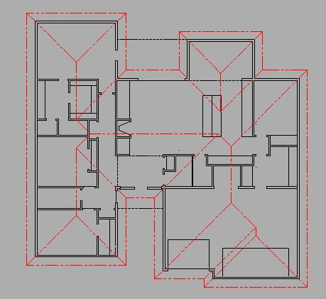

That appears to be more than just a simple roof.
What do you have to draw exactly? Are you drawing exterior elevations and want to know how the roof will look in each view?
I just need to know what it'll look like from the top view, the floorplan? I'm not sure..
It wouldn't be a floor plan it would be a roof plan.
Do you have to show the actual framing?
I mean I've tried to draw it out but it's completely wrong, just wondering what I need to do to fix it?
Why do you think it is completely wrong?

my teacher said it was. & no, i don't have to show the framing
And your teacher did not bother to elaborate on that point in any manner? He didn't say specifically what was wrong or suggest where you needed to make changes?
Do you have all your elevations drawn? What roof pitch(es) are you using?

What information have you been given to work from, there are a few places I would say need looking at, but how have you got to this point, what instructions have you had?
Well you can start by making the roof more flat than you have it drawn right now. The way you have it drawn makes it look like the roof has a 45° slope, which in the picture it clearly does not have that slope.

I am not sure why quite such a meal is being made of this.
As we know that it is a simple roof, and keeping to the premise that all roof pitches are the same, hip/valley lines are at 45 degrees (in plan) and ridge lines are at right angles to the span, I come up with this.
Looks fairly logical to me. I don't need elevations to draw the roof plan.

That is the outline of the roof just going off the picture. I don't want to do all the slopes because then I'd be doing all his work for him.
I got the plan of the house from that drawing. I could not see anything else. Perhaps you would be so kind as to post a screen view of what you are seeing.
I would draw the plan view before anything else, because it is governed by geometry (if it is going to fit)
And having taken a look at the artistic elevation, I would say that it is wrong. The left hand roof, second level (in the picture), and also the main ridge are wrong.

But anyway, the OP particularly asked for a roof plan, which does not entail elevations, which may be wrongly drawn already.
You need to make sure that each area of the roof is a flat plane, there are probably more methods of doing it but can you see how this is different to your drawing. The pitch can be anything from flat to 80 degrees.
