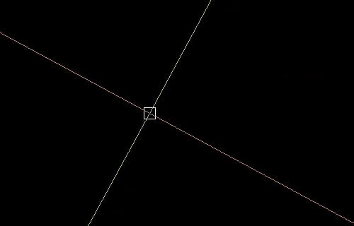

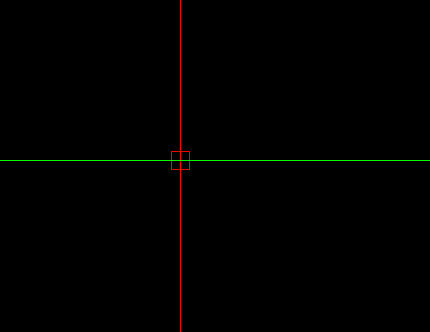

i currently have 2 machines running autocad map 3d 2012, and for some reason, when i apply a USC to the one machine, the crosshairs remain the same color, while on the other machine, they get a slight tint to them... which setting lets u have a different color crosshair when a usc is set. thanks alot! and sorry if this has been asked before, i did a search and couldnt find a solution.
No UCS:
UCS applied:

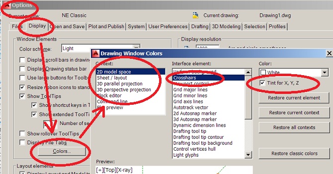

In Map is there such a command as Options > Display > Colors?
AFAIK, there is no setting to change it based purely on UCS and/or WCS
Are you sure it's not changing based on one of the following?
Model vs Layout
2D vs 3D Visual Style
Parallel vs Perspective
Nestly, u were close, i did manage to find the option. it was in the 3D parallel projection. and then just the color of crosshair
