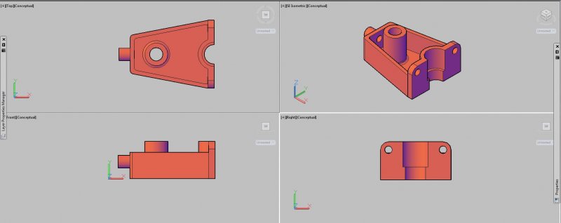

ReMark Posted November 20, 2013 Posted November 20, 2013 The method I demonstrated drawing a closed (half-width) profile of the threads required drawing 2/3rds of a triangle then doing an array. Hooked it all together using a single vertical line and two short horizontal lines then it was all over but the crying. Simple, quick and effective. I'm sure you could do the same. Were you so "OCD" on the drafting board as well? If so how did that go over with your boss? Did projects suffer (financially speaking) because of it? Re: lining things up. OSnaps still work in a 3D environment as far as I know unless AutoCAD changed something overnight. Being able to manipulate your viewing environment helps too. Are you aware you can have multiple viewports in model space that display different views of the object(s) you are working on? Quote
ReMark Posted November 20, 2013 Posted November 20, 2013 Model space: (4) equal 3D viewports. Top, front, side and SE isometric view. Visual style: Conceptual. Quote
mrkmpn Posted November 20, 2013 Author Posted November 20, 2013 Yeah I know about the different views, But my current monitor makes that difficult to see. I know Osnaps work in 3d, My problem in the past (from what I can remember) with osnaps was snapping to things on the other side of an object. Rather than the face I'm trying to snap to. As far as the drafting board... I never had that experience. I wear a lot of hats where I work, I'm the "IT guy", I've been stuck with advertising and marketing lately for Oil and Gas Trade shows, and my boss is one of those guys that thinks "Hey you know computers.... CAD is computer stuff.... figure out how to do this." I learned most of what I know following tutorials online, and learned more of the "under the hood" stuff when I took the class to get my certification. As with most things I get tasked with, I have to figure all this stuff out as I go. Sometimes it's easy to find help online, but sometimes I'm not even sure what I need to ask to solve my problem. That being said... projects never suffer from my OCD"ness", that's why most of my drawings (of tank batteries) are usually simple line drawings, using symbols for valves and such. But my boss has expressed interest in me doing more detailed drawings. I don't really have a problem doing elevation view and plan view drawings, but after seeing a few drawings in isometric view, he's wanting some of that from me as well. I usually don't have problems drawing the various stands etc... that we design. The only thing that really stumped me on this one was the u-joint. And my coming here for advice was for future drawings. The customer got the original drawing I attached in my 1st post, along with and explanation that that was the only was I could think to draw it on such short notice. As you can see from my last attachment "3D Test.pdf" above, I know how to do some 3D stuff. If you look at it there's a fiberglass tank flange I drew, mainly just to refresh my memory on that stuff. I think I need to start making a library of 3D blocks, and start messing with scaling and all that, and then take another stab at doing tank batteries in 3D rather than trying to figure out all the angles in 2D isometric. If this stuff where my primary job, I'm sure I'd be a lot further along now. I think it's about time to hit the boss up for a larger monitor. I used to have two separate ones, but lost one to our paint shop for their paint color matching computer. Quote
