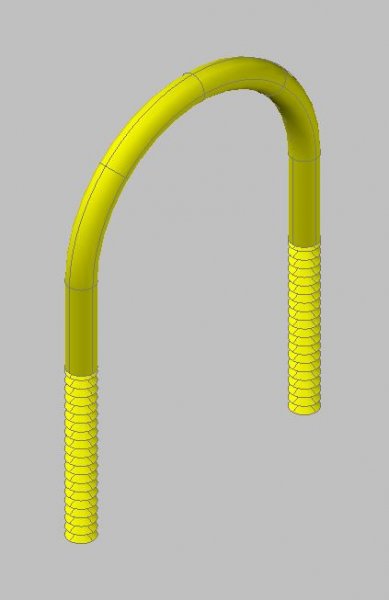

ReMark Posted November 19, 2013 Share Posted November 19, 2013 3D U-Bolt: Solid model as drawn in plain AutoCAD. Quote Link to comment Share on other sites More sharing options...

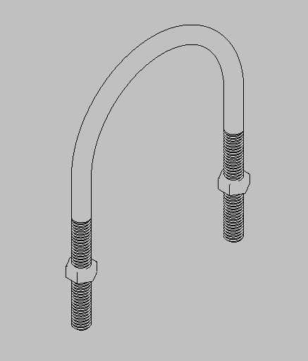

ReMark Posted November 19, 2013 Share Posted November 19, 2013 2D U-Bolt. Created via the SOLPROF command from a 3D solid model in plain AutoCAD. Quote Link to comment Share on other sites More sharing options...

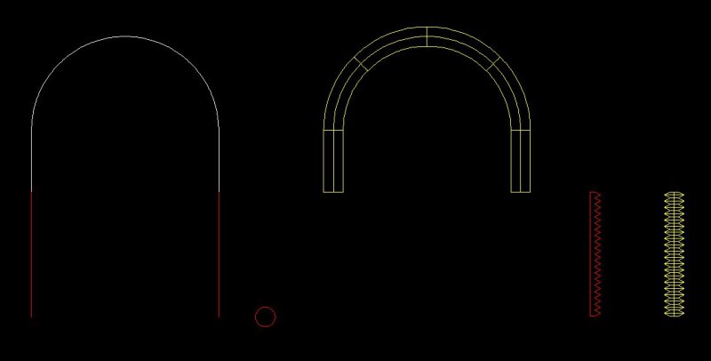

ReMark Posted November 20, 2013 Share Posted November 20, 2013 One way to create a 3D U-Bolt. Everything in the image was created in a top down view using a 2Dwireframe visual style. On the far left is my 2D centerlines. The red lines represent the threaded portion of the U-bolt. The yellow objects you see are 3D solids. The smooth top portion of the U-bolt was created by sweeping a circle while the "threads" were created by revolving a closed profile. Since all we need is a pictorial view I see no reason to use a helix and a swept profile of the tooth. On the far right is the 3D model of the threads. Are you with me so far? Quote Link to comment Share on other sites More sharing options...

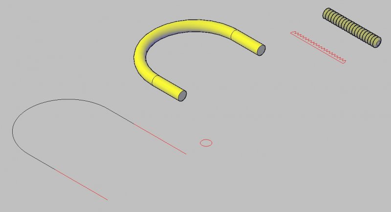

ReMark Posted November 20, 2013 Share Posted November 20, 2013 Now what's changed? I've simply switched to the standard SW Isometric view of my objects and used a Conceptual visual style. Nothing has been rotated at this point. Quote Link to comment Share on other sites More sharing options...

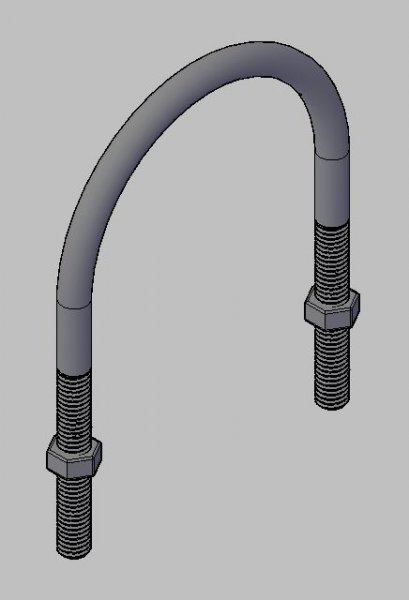

ReMark Posted November 20, 2013 Share Posted November 20, 2013 Can you see me now? To achieve this I changed the orientation of my UCS and rotated the 3D solids. I moved the single solid thread to one leg of my U-bolt and copied it to the second. I unioned everything together and switched to a Realistic visual style. It probably took no more than 5 minutes to create. Note that changing your UCS can be done manually (old school) or via the Dynamic UCS. Choose the option you feel the most comfortable with. Disclaimer: The above was meant for demonstration purposes only. Any semblance to accuracy was purely accidental! Quote Link to comment Share on other sites More sharing options...
ReMark Posted November 20, 2013 Share Posted November 20, 2013 The threads were bugging me so I changed them from very coarse to fine. Quote Link to comment Share on other sites More sharing options...
