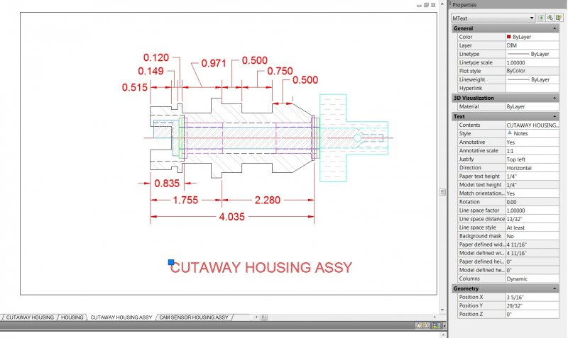

When I add a text box label in Layout space. the text box is in the normal horizontal
position, as in photo 1
when i preview it in the plot preview the text box is vertical.
the drawing plots out that way too.
In the properties box the rotation is grayed out.

Is the viewport set to the same annotation scale? Check for a duplicate.
Annotation scale is set 1:1 in Model and Layout.
No duplicate.
Thanks for the help. I found the problem.
I pasted the Text Box on the View Port, not in the active view port.
Went back and pasted the Text Box in the active View Port,
every thing is working properly now.
