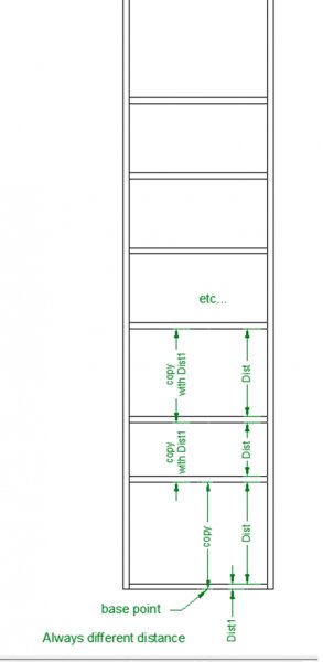

martinle Posted February 29, 2016 Posted February 29, 2016 Hello, would ask could be whether one could change this Lisp even so use it to copy with different distances? Here but you'd have the thickness of the copied object into account with 1) query dist1 2) query Dist, 3) Command "copy" ......... 4) Command "copy" ......... etc ...... Thanks for your help! best regards Martin Quote

martinle Posted February 29, 2016 Posted February 29, 2016 Hello Marko, Thank you for your help. I know the command to copy several times. This command and transparent command track I use. Copy In many but this is very troublesome. I would be glad if you could do this faster without each time you copy a Refferenzpunkt specify. Greetings Martin Quote

martinle Posted February 29, 2016 Posted February 29, 2016 Hello Marko, Not quite. If I give you the base point, and then the vector point then this distance should be added to the query distance. For example, if the distance from the base point to the vector point is 20 and the detection distance 100 is then the copy should be 120 units copied. Always the 20 units to enter. Greetings Martin Quote
marko_ribar Posted February 29, 2016 Posted February 29, 2016 You are telling me that you can't select object(s), pick base, choose direction vector and then specify 20, then 100, then 20, then 100, then 20, then 150, and so on... Quote
martinle Posted February 29, 2016 Posted February 29, 2016 Hello Marko I have done it with your help! Many thanks ;Lisp von Marko Ribar ;http://www.cadtutor.net/forum/showthread.php?82934-Accumulative-copy-lisp&p=655507#post655507 (defun c:ccdd ( / *error* ss cm p pp osm d dl v pn DD ) (defun *error* ( msg ) (if cm (setvar 'copymode cm) ) (if osm (setvar 'osmode osm) ) (if msg (prompt msg) ) (princ) ) (setq ss (ssget "_:L")) (setq cm (getvar 'copymode)) (setvar 'copymode 0) (setq p (getpoint "\nPick or specify base point : ")) (setq pp (getpoint "\nPick or specify direction vector point : " p)) (setq DD (distance p pp));;;;;;;;;;;;;;;;;;;;;;;;;;;;;;;;;;;;;;;;;;;;;;;;;;;;;;;;;; (setq osm (getvar 'osmode)) (setvar 'osmode 0) (while (progn (initget 2) (setq d (getdist "\nSpecify distance <Exit> : ")) (setq d (+ d DD)) ) (if d (progn (setq dl (cons d dl)) (setq v (mapcar '/ (mapcar '- pp p) (list (distance p pp) (distance p pp) (distance p pp)))) (setq pn (mapcar '+ p (mapcar '* v (list (apply '+ dl) (apply '+ dl) (apply '+ dl))))) (command "_.COPY" ss "" "_non" p "_non" pn) ) ) ) (*error* nil) ) Quote
