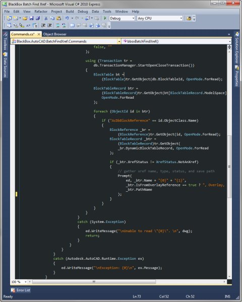

BlackBox Posted November 15, 2013 Share Posted November 15, 2013 FWIW - I haven't posted this yet, as I'm simply not done yet (coding only in your personal time takes a lot longer than you might expect!), but I've already ported the LISP code you liked to .NET API. Put simply, the query portion of the two is significantly faster in .NET, enough to justify porting the code from the outset, but then also exposes additional features, that again, I simply haven't finished adding into this app. Quick snippet of working code: Quote Link to comment Share on other sites More sharing options...
