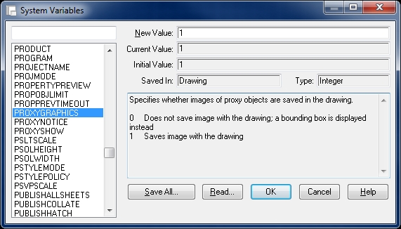

What value is your PROXYGRAPHICS variable set to in your 2012? See this description from Express Tools - System Variables:
Alright I checked the Proxygraphics and they were set to 1, but I just did the -EXPORTTOAUTOCAD again and saved it as a different name. I guess that makes all the difference.
