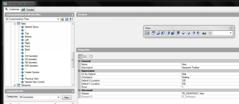

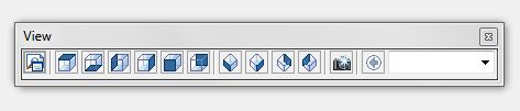

I think you would have to create a new Viewpoint toolbar which really isn't all that difficult. I'm assuming that you have already done this while playing around at customizing AutoCAD. Am I correct?
What your new toolbar should look like.

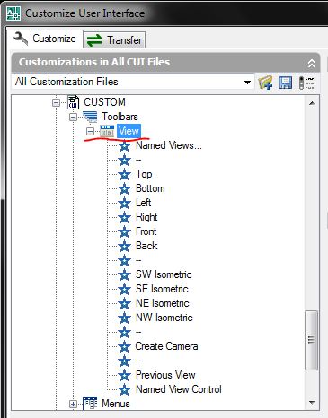

The commands that will be needed to populate your new View toolbar.

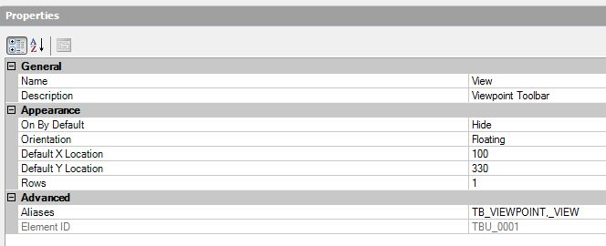

Your toolbar properties. They are exactly the same as the original with one exception. The Element ID for the original View toolbar was ID_TbViewpoi. Now the reason mine shows up as being grayed out is I replicated the toolbar under Partial CUI Files > Custom > Toolbars. You'll be replacing the original so maybe you'll be able to correct that. Maybe? I was unwilling to go as far as to delete my original View toolbar just to test that theory. I'll leave it in your capable hands.

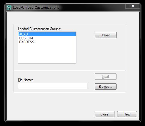

I'm not following how MENULOAD would resurrect an original toolbar that was deleted. Assuming one runs that command the loaded customization groups ACAD, CUSTOM and EXPRESS would already show up. What does one do at the point? Do you first Unload ACAD then Load it again?
You would browse to the appropriate .mnu (for the OP I believe) or .cui or .cuix and reload it.

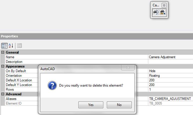

I'm trying to duplicate what the OP said she did using AutoCAD 2007. But in my case I deleted the Camera Adjustment toolbar. This is what I saw just before I answered "Yes".
Edited by ReMark
Now I've invoked MENULOAD. This is what I see. My question is, what do I do now to get the Camera Adjust toolbar back?
Hit Browse and load the appropriate .cuix in your case ACAD.cuix
You will need to unload it if it is currently loaded or you may need to load the backup file.

I tested your advice (unload then load ACAD.cui) and it failed to bring back the Camera Adjustment toolbar.
