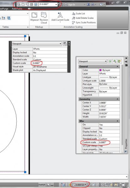

You've returned to your drawing and you want to know "What is my viewport scale and where would I find this information?"
Look at the image above. It shows four different ways to determine the viewport scale (circled in red). They are...
1. Viewport toolbar (at the top). Position of toolbar, if enabled, will vary by user.
2. Quick Properties window assuming you have this enabled.
3. Properties palette.
4. Status Bar (at the bottom).
Choose the option(s) that work best for your situation.

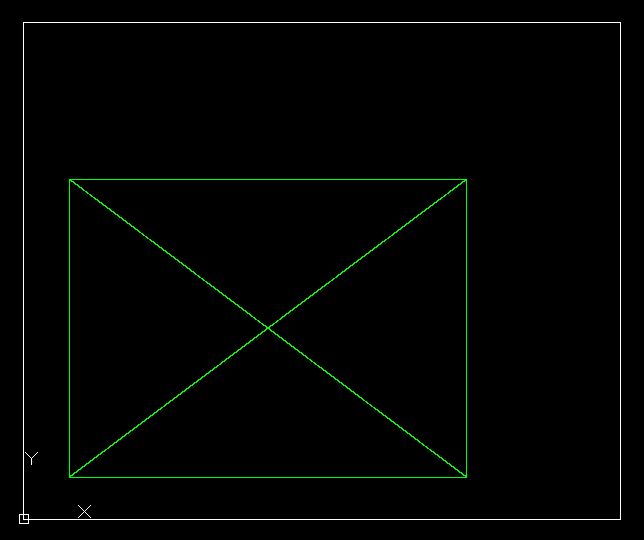

If the property is 100'x75' then I would draw nothing larger than a 150'x125' rectangle with the bottom left hand corner located at 0,0. Then go back and draw the site plan itself within this rectangle. See example below. The white box is 150'x125'. The green box with the crossed lines through it represent your site plan (100'x75'). Are we clear?
And to repeat, if you draw your model scale objects at FULL size the issue of "scale" can be handle via a layout with a single viewport.

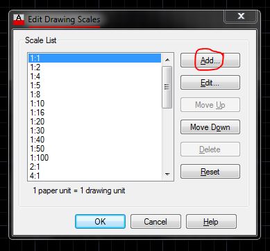

To add a new scale to our list of scales we have to edit what AutoCAD refers to as the Scale List. One way to do this (Yes, I'm old school, I enter some commands at the command line. Your laughter does not faze me.) is to invoke the SCALELISTEDIT command. That will bring up the window shown in the image above. Notice the "Add" button I've circled to the right. We're going to use this to add the scale of 1"=20'. Ready?

Remember that ratio mentioned in the last line of my previous post? Well this is where we enter it after hitting the Add button. Note the three areas circled in red. The top one is our new scale which in this case is 1"=20'. The next two areas are where we enter the ratio. The ratio really comes into full play when we eventually plot our drawing as AutoCAD will take note of the scale assigned to our viewport and plot everything within it according. The beauty of it is we plot from a layout at 1:1 scale we do not plot "to scale".
So in this case the ratio is 1 paper unit represents the equivalent of 240 drawing units. The 240 number is derived from multiplying 20 x 12. If we want a scale of 1"=40' the ration would be 1 = 480 (40 x12). Follow me?
This then accounts for how we were able to depict a piece of property that is 100' long on a piece of paper that is 8 1/2" long. At 1"=20' we could, if we went right to the edges of our paper, show a building lot that is 170' but keep in mind we do have a limitation in regards to the printable area of our paper which is probably closer to 7 1/2" or 150' (7.5x20). I'd cut that back just a bit further (wiggle room) and limit myself to a building no longer than 140' at this particular scale. If our building were larger we'd have no option but to use a different scale so we could still fit it on our paper. Whew! That was a mouthful. Have your eyes clouded over and has your brain gone numb by now? Couldn't blame you if it happened. LoL
