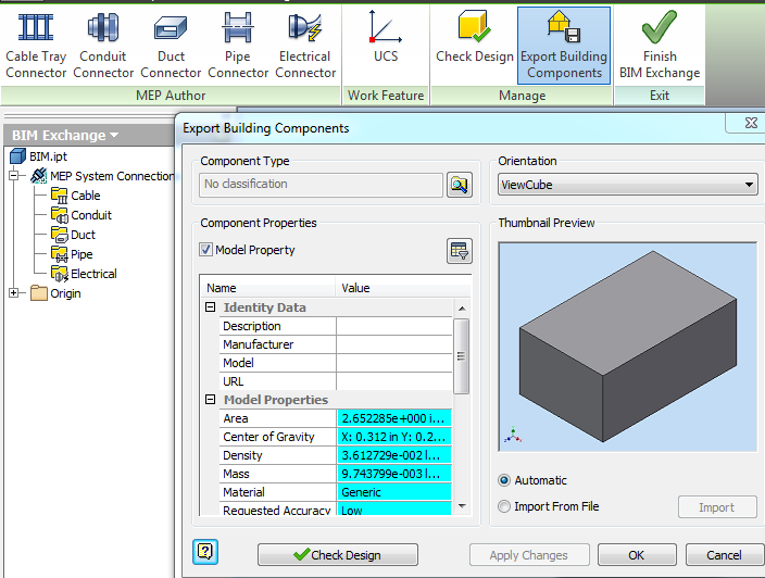

JD Mather Posted November 9, 2013 Posted November 9, 2013 Unfortunately I don't have an export button under the big "I" application menu. Wrong location to look. First, check Tools>Add-ins and make sure BIM Exchange and BIM Simplify apps are loaded. Then click on the BIM tab on the Ribbon. (also, you don't mention what version of Inventor you have - there was a change in r2014) Inventor Fusion was nothing like Autodesk Inventor. I don't understand how it got the "Inventor" name. Parametric modelers are solid (or surface) modelers. Quote
hertz hound Posted November 9, 2013 Author Posted November 9, 2013 First, check Tools>Add-ins and make sure BIM Exchange and BIM Simplify apps are loaded. Fusion must be really striped down. There is no tools tab, only home vault and view. I right clicked on the ribbon to see if all tabs and panels were selected (Viewable) and they were. I looked every where, and there are not many places to look, and I can't find Tools, add-ins, bim exchange or apps. There are many things missing from what the library book tells me to click. I have the 2012 version of Inventor Fusion. The book I borrowed is for Inventor 2013 and 2013 LT. Would LT have what you are showing me or would that be limited also? Quote
Pablo Ferral Posted November 10, 2013 Posted November 10, 2013 Inventor 2014 can export parametric parts to Revit 2014. Fusion desktop is a direct modeler. It's not parametric and its file type is DWG. It is no longer being developed. Fusion 360 Is a wicked cool web app. It's still kind of Beta. It's not parametric yet... once no idea weather it will ever export to Revit. http://fusion360.autodesk.com/resources Quote
