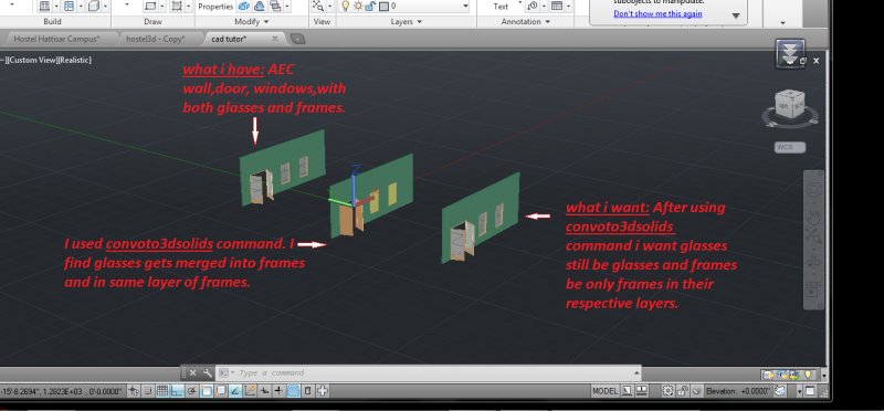

Bivek Posted November 8, 2013 Posted November 8, 2013 Hi, for some reason i need to convert the aec doors and windows into autocad 3d solids, But as i use convoto3dsolids command to do that, both frames and panels gets attached into same layer and becomes same block, so i can't apply separate material to frames and panels. So how can i separate these two... in autocad architecture 2014. Quote

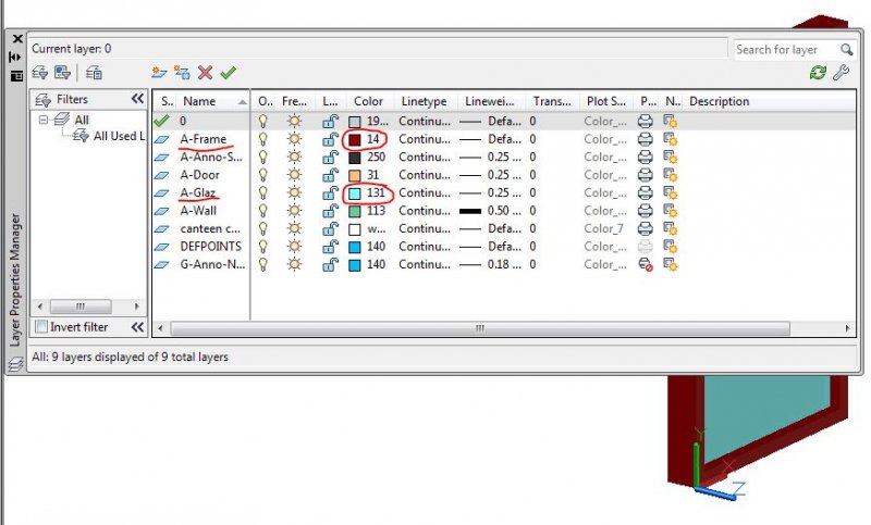

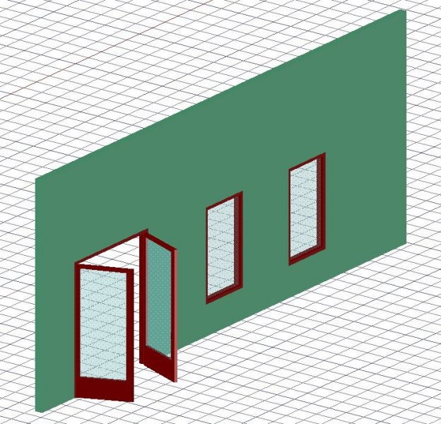

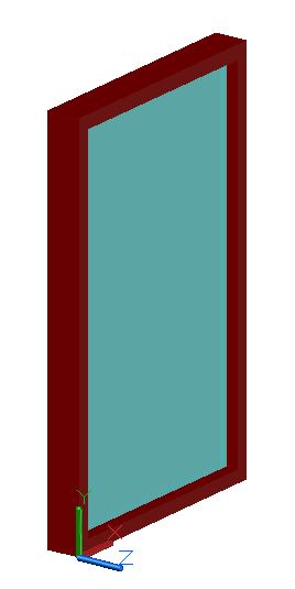

ReMark Posted November 26, 2013 Posted November 26, 2013 Well if you insist. Is this what you wanted? The window frame and glazing are 3D solids that exist on layers A-Frame and A-Glaz. Quote
ReMark Posted November 26, 2013 Posted November 26, 2013 Eh, might as well get the door on the A-Frame layer and the glass on the A-Glaz layer too right? Quote
Bivek Posted November 26, 2013 Author Posted November 26, 2013 Now i see my problem makes some sense... I don't have the A-Frame layer?? That is why perhaps both the glass and the frame would catch the same layer A-Glaz. I need to do this becoz i render my drawing in lumion which requires objects to be in seperate layer to apply a material and thus i need glass and the frame to be in separate layer and that lumion which i use won't accept aec objects.. Quote
ReMark Posted November 26, 2013 Posted November 26, 2013 Creating a new A-Frame layer will not solve your problem all by itself. The glass in the door will still be on the A-Door layer. The window frames will still be on the A-Glaz layer. Notice I put my door and window frames on the same layer. I also put all my glass on the same layer. Quote

Bivek Posted November 28, 2013 Author Posted November 28, 2013 Until now i'm creating openings in the walls, creating windows using plain autocad method like rec, reg, ext etc.. and fitting them in the openings. I recently switched to autocad architecture by looking at its simplycity and easy handling of doors and windows.. How ever how better it would have been if i could use the window of default autocad architecture. I repeat, i needed this coz i render it in lumion software which requires objects to be in seperate layers for seperate materials to be applied and lumion won't accept aec objects so aec objects need to be converted into 3dsolids using convoto3dsolids, but as i do it the glass gets attached into frames layer and i can't apply glass to glass and frame material frame seperately in lumion.. Quote
