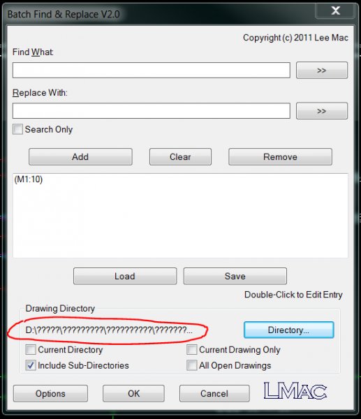

p0peye Posted November 6, 2013 Posted November 6, 2013 Hi all, I am a bit frustrated as my second question is (also) on first grade (elementary school) level, but I have already spent too much time trying to figure it out: I need to go trough many old drawings and replace the font type, and to change/exclude some text from exploded drawings - (M1:10) for example. Also to change font type for all text (the height and bold/italic format should remain). I found lee-mac's ultimate tool (I'd say based on description) - BFindV2-0.lsp http://www.cadtutor.net/forum/showthread.php?46135-Batch-Find-amp-Replace-Text& and tried to use it - but, again, I get not so popular answer: Command: bfind Unknown command "BFIND". Press F1 for help. I tried to find a solution: http://www.cadtutor.net/forum/archive/index.php/t-3328.html http://forums.autodesk.com/t5/AutoCAD-2010-2011-2012-DWG/Lisp-routine-won-t-run/td-p/2854918 ... ... ... but nothing works for me Basically, I can upload the lisp, I see it in tools- Load application - loaded applications - although I see them as greyed. However - at least one of other greyed-out LISP are working (HyperBonus.LSP)? This also happens for a few more LISPs: BFindV2-0.lsp StripMtext v5-0c.lsp TextReplace1.lsp VisualStyleSwitch.lsp They are all greyed out and the "unload" option is not accessible(?). I am avare that the mentioned lisps are well known and tested, and the problem is to solve elsewere - on my PC - but I am out of ideas. Any one has one? Thanks in advance -------------------------- Edit: Found it my self - and it didn't take me more then few hours... The path of the LISP location must not contain Cyrillic letters. Leaving this post as a possible solution for potential future users in similar trouble... Quote

p0peye Posted November 7, 2013 Author Posted November 7, 2013 No, Lee Mac - thank You for creating (and sharing) such a useful LISP. Although I had to rename the target files, and put them in a new folder as the BFIND also don't "see" the Cyrillic path/file names... (see attached files) However - if I open the same file (with Cyrillic path/name) in AutoCad, and appload bfind from the folder with Latin path - I can edit the text. Pitty - as the batch option is very useful... Nevertheless - again - thank you very much for BFIND One question - when I select the predefined "search and replace" text - shouldn't it be put in the "find what" and "replace with" fields? I am confused as nothing visual happens when I select the predefined text... (I can't believe it - I am off-ing my own post... ) @pBe - I was warned to behave myself here - if I could speak freely, I would write, for example: "I get *#@!qł*Ł@§§!! answer" Quote
Lee Mac Posted November 8, 2013 Posted November 8, 2013 No, Lee Mac - thank You for creating (and sharing) such a useful LISP. You're very welcome! Although I had to rename the target files, and put them in a new folder as the BFIND also don't "see" the Cyrillic path/file names... Without testing I would have predicted that Cyrillic characters in the filepath would present an issue, since many AutoLISP functions cannot process characters outside of the standard ASCII character set. One question - when I select the predefined "search and replace" text - shouldn't it be put in the "find what" and "replace with" fields? I am confused as nothing visual happens when I select the predefined text... You should be able to double-click on the entries in the list box in order to edit the entered values. Quote
