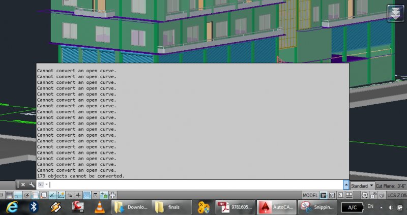

Friends, when i try to convert the aec objects from autocad architectural to autocad 3d solids the command line replies cannot convert an open curve..Then how can i convert the objects. The command worked last time for my prelimnary design but now.. RegardsUntitled.jpg:o

Hi, actually i made a silly mistake, What last time i did was convoto3dsolids command which converted the aec objects into 3d solids, but this time i mistakely used convotosolid command which was not the correct command. However the problem solves with convoto3dsolids command. Thanks
