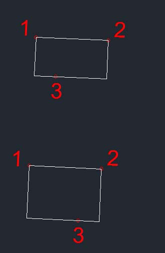

I need to add one more command
I need to make rectangle with 3 points like the photo

Why? Does Alan's 3 point rectangle require a three corner pick?
This works on A2012...
(defun c:RX (/ p1 p2 p3 l1 l2 l3 l4 pea)
 (setq p1 (getpoint "\nPick first point: ") p1 (trans p1 1 0))
 (setq p2 (getpoint (trans p1 0 1) "\nPick second point: ") p2 (trans p2 1 0))
 (setq p3 (getpoint "\nPick third point: "))
 (setq l1 (entmakex (list '(0 . "LINE") (cons 10 p1) (cons 11 p2))))
 (command "_.offset" "t" l1 p3 "")
 (setq l2 (entlast))
 (setq l3 (entmakex (list '(0 . "LINE") (cons 10 p1) (cons 11 (cdr (assoc 10 (entget l2)))))))
 (setq l4 (entmakex (list '(0 . "LINE") (cons 10 p2) (cons 11 (cdr (assoc 11 (entget l2)))))))
 (setq pea (getvar 'peditaccept))
 (setvar 'peditaccept 1)
 (command "_.pedit" l1 "j" l1 l2 l3 l4 "" "")
 (setvar 'peditaccept pea)

Nice solution Marko! Simple, but effective.
I would add a protection for the case the third point lays on the line defined by the first two.

(defun c:test (/ p1 p2 p3 p4 p5 p6)
 (initget 1)
 (setq p1 (getpoint "\nPoint 1:   ")))
 (initget 1)
 (setq p2 (getpoint p1 "\n2nd Point:   "))
 (initget 1)
 (setq p3 (getpoint p2 "\Opposing edge Point:   "))
 (if (setq p4 (inters p1 p2 p3 (polar p3 (+ (angle p1 p2) (* pi 0.5)) 1) nil))
     (setq p5 (polar p1 (+ (angle p1 p2) (* pi 0.5)) (distance p1 p4))
           p6 (polar p2 (+ (angle p1 p2) (* pi 0.5)) (distance p1 p4)))
 (and p1 p2 p5 p6
(entmake (list (cons 0 "LINE")(cons 10 p1)(cons 11 p2)))
(entmake (list (cons 0 "LINE")(cons 10 p1)(cons 11 p5)))
(entmake (list (cons 0 "LINE")(cons 10 p2)(cons 11 p6)))
(entmake (list (cons 0 "LINE")(cons 10 p5)(cons 11 p6)))
 (prin1))
Would need some 3D point error checking.
-David
David, I modified p5 and p6
  (initget 1)
  (initget 1)
  (initget 1)
      (setq p5 (polar p1 (angle p4 p3) (distance p4 p3))
            p6 (polar p2 (angle p4 p3) (distance p4 p3))
  (and p1 p2 p5 p6
       (entmake
           (list
               (cons 0 "LWPOLYLINE")
               (cons 100 "AcDbEntity")
               (cons 100 "AcDbPolyline")
               (cons 90 4)
               (cons 70 1)
               (cons 10 p1)
               (cons 10 p2)
               (cons 10 p6)
               (cons 10 p5)

Another version:
(defun c:myrec ( / nv oc p1 p2 p3 p4 p5 p6 )
   (if
       (and
           (setq p1 (getpoint "\n1st point: "))
           (setq p2 (getpoint "\n2nd point: " p1))
           (setq p3 (getpoint "\n3rd point: " p1))
           (setq nv (trans (mapcar '- p2 p1) 1 0 t)
                 oc (trans '(0.0 0.0 1.0) 1 0 t)
                 p4 (trans p1 1 nv)
                 p5 (trans p2 1 nv)
                 p6 (trans p3 1 nv)
           (entmake
               (list
                  '(000 . "LWPOLYLINE")
                  '(100 . "AcDbEntity")
                  '(100 . "AcDbPolyline")
                  '(090 . 4)
                  '(070 . 1)
                   (cons 010 (trans p1 1 oc))
                   (cons 010 (trans p2 1 oc))
                   (cons 010 (trans (list (car p6) (cadr p6) (caddr p5)) nv oc))
                   (cons 010 (trans (list (car p6) (cadr p6) (caddr p4)) nv oc))
                   (cons 210 oc)
With dynamic effect:
(defun c:myrec ( / nv oc p1 p2 p3 p4 p5 pl )
   (if
       (and
                 p3 (trans p1 1 nv)
                 p4 (trans p2 1 nv)
           (princ "\n3rd point: ")
           (while (= 5 (car (setq p5 (grread t 13 0))))
               (redraw)
               (setq p5 (trans (cadr p5) 1 nv))
               (mapcar '(lambda ( a b ) (grdraw a b 1 1))
                   (setq pl
                       (list p1 p2
                           (trans (list (car p5) (cadr p5) (caddr p4)) nv 1)
                           (trans (list (car p5) (cadr p5) (caddr p3)) nv 1)
                   (cons (last pl) pl)
           (if
               (and
                   (listp (cadr p5))
               (entmake
                   (list
                      '(090 . 4)
                      '(070 . 1)
                       (cons 010 (trans (list (car p5) (cadr p5) (caddr p4)) nv oc))
                       (cons 010 (trans (list (car p5) (cadr p5) (caddr p3)) nv oc))
                       (cons 210 oc)
           (redraw)
The above should also work in all UCS & Views.

Mr Lee i have a litle problem with this lisp
when i select point 1 and point 2 the osnap is on. When i am trying to pick the point3 the osnap is off why? can you fix it !! Thanks
Prodromosm, that behavior is from the use of dinamyc input for third point (GRREAD); unfortunatly this doesn't work with OSNAP modes.
As MSasu as indicated, when monitoring user input using the AutoLISP grread function, all standard drawing aids (Object Snap / Orthomode / Tracking etc.) are unfortunately disabled.
The DynDraw.arx utility by Alexander Rivilis presented in the thread suggested by MSasu offers an alternative to the grread function permitting the use of all drawing aids, but the program would need to be rewritten for use with this function.
Otherwise, I would suggest that you simply use the non-dynamic version that I have provided above.
