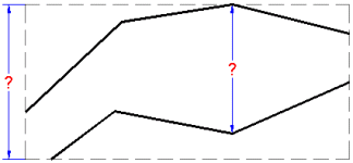

radiman Posted November 4, 2013 Share Posted November 4, 2013 Is there any way to find out the Maximum vertical distance between two polylines? Quote Link to comment Share on other sites More sharing options...
MSasu Posted November 4, 2013 Share Posted November 4, 2013 Seems that you will need to provide more information on this. Are those polylines singe or multi segment? Were drew in plan or in 3D? For the second case, were on the same vertical plane, in parallel planes or in an arbitrary relative position? Quote Link to comment Share on other sites More sharing options...
nestly Posted November 4, 2013 Share Posted November 4, 2013 Perhaps "vertical" means "Y" direction, in which case a bounding box routine would suffice. Quote Link to comment Share on other sites More sharing options...
radiman Posted November 4, 2013 Author Share Posted November 4, 2013 2 multi segment polylines (2D), I wanna find the maximum Y distance between them? Quote Link to comment Share on other sites More sharing options...

radiman Posted November 7, 2013 Author Share Posted November 7, 2013 I was out of office, so no autocad! I'm interested to know the Y-distance what I showed in the picture . The polylines that I have are very long and curvy so their highest and lowest points are located in different parts, look here: Basically I want to know the max Y distance between two Plines not between their 2 vertices! Quote Link to comment Share on other sites More sharing options...

lrm Posted November 14, 2013 Share Posted November 14, 2013 I believe the maximum distance will be at one of the vertices of the two polylines. Therefore you can start by setting Max to the distance from the 1st vertex of the top line vertically down to the intersection point of the bottom line. Then go to the top line's second vertex and determine the length from there to the bottom line. If it is larger than Max redefine Max to that value. Continue with the rest of the vertices in the top line then go vertex to vertex along the bottom polyline. Quote Link to comment Share on other sites More sharing options...

MSasu Posted November 14, 2013 Share Posted November 14, 2013 So, Radiman, you were looking for the distance marked with yellow below? Please check that Lrm have a very good observation (as long there are no curved segments along those polylines); may want to check Lee Mac's intersection functions library. May want also to ask a Moderator to move your thread into Development sub-forum for extra support. Quote Link to comment Share on other sites More sharing options...
