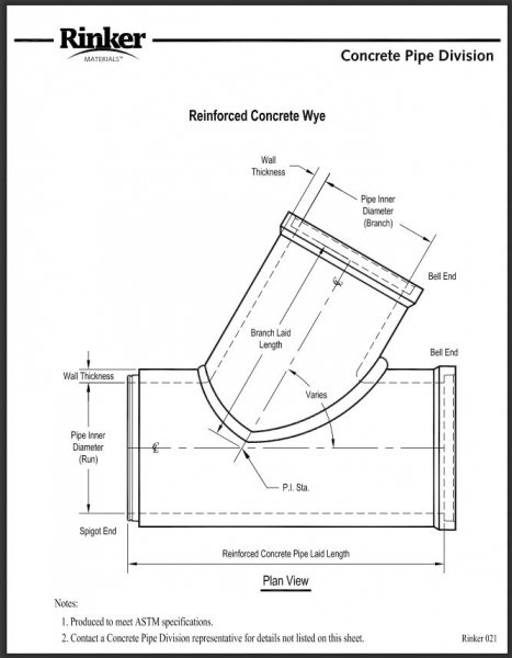

ReMark Posted November 4, 2013 Posted November 4, 2013 Plan view is fine you say? Maybe your elbows are floating somewhere directly above the pipes they should be connected to. That could explain why you see them in plan view but not in other views (like SE isometric). Quote
sandiegophil Posted November 4, 2013 Author Posted November 4, 2013 I get this in plan: and this in 3d: the null part is fine to a point, it always comes in larger that the OD of the largest pipe.... Quote
ReMark Posted November 4, 2013 Posted November 4, 2013 Whoa! You're using a sphere to create your elbows? What size pipe are we talking here? Quote
sandiegophil Posted November 4, 2013 Author Posted November 4, 2013 they're only 18" RCP in this location. please tell me there's a better way. don't really know how the spheres become default. if i try try to use a part defined shape the file crashes. Quote
ReMark Posted November 4, 2013 Posted November 4, 2013 A long time ago Civil 3D did not have bends, tees and branches so the user would substitute a null structure. Gadz, it's 2014, please don't tell me Civil 3D still does this? Quote
sandiegophil Posted November 4, 2013 Author Posted November 4, 2013 if they're in there, I certainly can't find them. It would be my opinion that it would 'join' connected pipes automatically........ Quote
ReMark Posted November 4, 2013 Posted November 4, 2013 I was under the impression that Civil 3D expects there to be a structure at the junction of two pipes (ex. - manhole). Where are you Tiger? I thought you were the new Civil 3D guru on the block. If anyone should know what to do in this situation it's you isn't it? Quote
Tiger Posted November 6, 2013 Posted November 6, 2013 If the connectors do not render at all, I am wondering if there is a rendering material applied to them? And if you do not have structures (manholes), and are using 2014 - perhaps try Pressure Pipes instead? they have other connectors available. I'll see if I can get a test going here and check it for you. It's a support-day for me anyway Quote
ReMark Posted November 6, 2013 Posted November 6, 2013 Tiger: Does Civil 3D 2014 actually have branches, tees and wyes suitable for use with RCP? Quote
Tiger Posted November 6, 2013 Posted November 6, 2013 For pressure pipes yes, som. (update: tee's and elbows I can find, no wyes) But that wasn't introduced until 2013 so it's still heavily under development. We construct our own so I have not looked to deep into how the stuff that comes with the program looks. For gravity pipes, we do not use branches, and use a localized version so I can't say what comes with C3D in the States. Here is how bends look like in pressure pipes Quote
ReMark Posted November 6, 2013 Posted November 6, 2013 (edited) Pressure pipe as in a water distribution system. OK I can buy that but what about sanitary and storm sewer design? I don't understand how a civil program would not have tees, wyes, elbows, reducers/increasers and adapters for reinforced concrete pipe included as part of the package. Not all sewers are manhole-to-manhole or catchbasin-to-manhole. Edited November 6, 2013 by ReMark Quote
