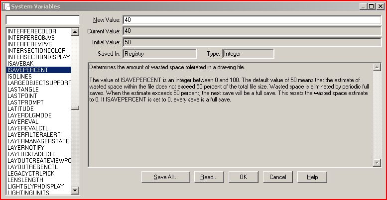

Dadgad Posted November 3, 2013 Posted November 3, 2013 Welcome to CADTutor. Are you using ADAPTIVE DEGRADATION? On the SYSTEM tab in your OPTIONS, in the PERFORMANCE settings. I believe the default is 5, but it can be set as high as 60. What is your ISAVEPERCENT variable set to? You sound savvy enough that it isn't that your SNAP setting (not O Snaps) are enabled? Quote

Dadgad Posted November 3, 2013 Posted November 3, 2013 You failed to report what your ISAVEPERCENT system variable is set to? Quote
rasnoland Posted November 3, 2013 Author Posted November 3, 2013 Dadgad said: You failed to report what your ISAVEPERCENT system variable is set to? yes, sorry I forgot. I had ISAVEPERCENT set to 50 (the default I believe). I changed that to 25, but I didnt notice any change in performance.. Also I have dissabled Adaptive degradation altogether, also without increase in performance (is this because i only draw in 2D?) Dana W said: Have you researched ways to speed up your computer in general? Almost everyone's computer boots up dozens of unneccesary processes and services that slow it down. Have you looked at Windows task manager to see what is running with AutoCad that is hogging a lot of resources? I think the command line being turned off is an incorrect assumption. It may be that turning off pretty much anything would speed it up. Are there internet windows open while you are working? When your drawings are pretty big? How big? Does your virus software allow you to exclude certain programs from the Open/Access/real time scan options? How often does your email do an auto send/receive? How often does your AutoCad do an autosave? If you have one of those free download virus programs that does not have any options, you may as well turn it off anyway. DanaW I will have a look at the system as you suggest and report back. What application do you use to streamline windows 7? Quote
