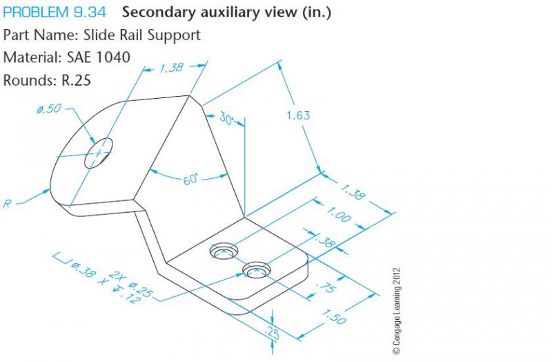

Does the instructor get a failing grade for posting an assignment with missing information? How is it that this sort of thing is so common? Are instructors in too much of a rush or are they just not paying attention?
Looks to me like it is book author's mistake, not the instructor. (although you would think that unless this is the first time the instructor assigned this particular problem - they would be aware of the missing information and assumptions)

In close tolerance machining we expect complete and accurate drawings, but in architectural, civil, structural.... I doubt much would get built without making educated/experience driven assumptions. There are times when decisions need to be made using incomplete information (or we can sit on our hands and do nothing, except complain about the missing information).
It is most defiantly a text book mistake, our instructor is very good about helping but I think this is the first time with this text and we are finding lots of mistakes.

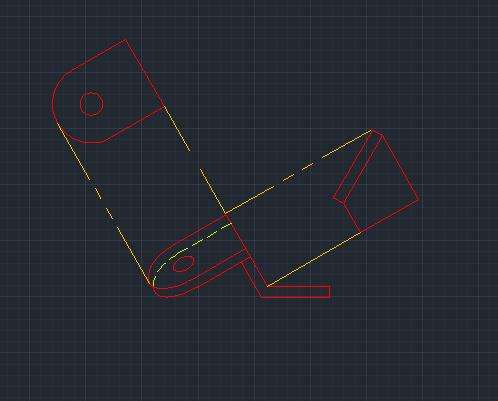

I just need a link or two that helps explain how to start this drawing. I can draw it in solidworks just fine but in AutoCAD just having issues getting started.

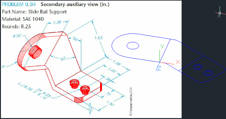

Again there is a fair bit of info not given, I would start with the base (2 holes) then draw the middle section as perpendicular and the top running 90 degrees off that following the sloping edge, and finally thicken up the parts and then from a front view rotate the center and top pieces by 30 degrees.
I don't follow? So draw every perpendicular and then rotate?

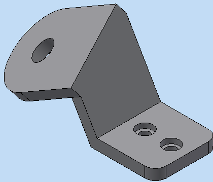

In Solidworks no problem I drew it easily.
In AutoCAD not so much, I think I am over thinking it. This is what I have so far, I have not done the 2 small counterbore holes yet as they are easy once drawing is close to done.
I agree it should be easy, my brain is just getting in the way I think ;)

Project your secondary auxiliary off of the primary auxiliary (the 1.38 is known the R is found from the primary auxiliary).

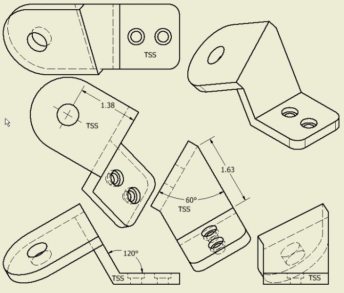

I'm actually OK with this one, although I do think there should be a note or individual thickness dimensions for each plane.
my quick attempt -->

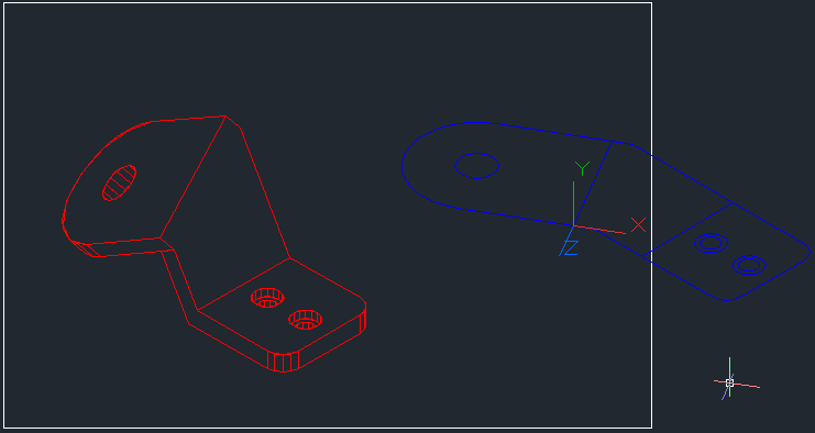

I drew this one flat then rotated the sections and finally offset for thickness. And the original one is indeed drawn correctly this time, it lines up well between the image and the model.
Whoops. I just noticed I blew one of the dimensions in my demo 1.62 should have been 1.63 :oops:
