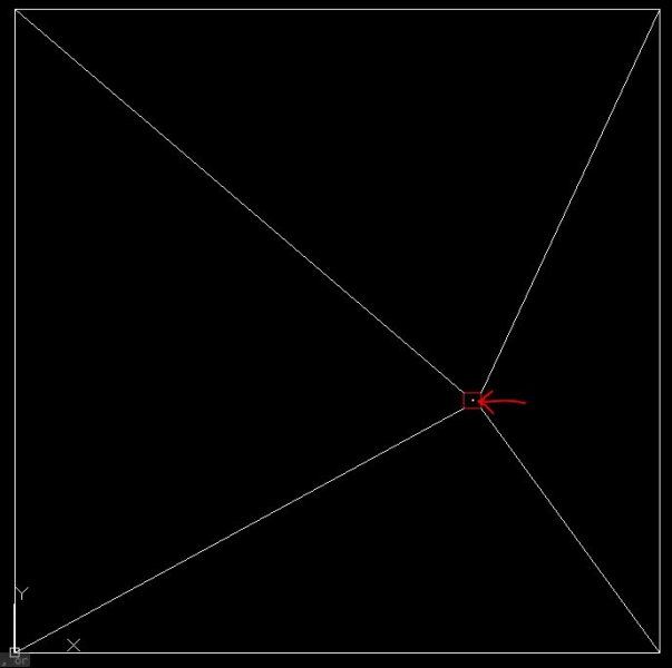

ReMark Posted November 2, 2013 Posted November 2, 2013 Here is what the student is faced with on this project. The white square defines the limits of the drawing which would be 0.0000,0.0000 and 2000000,2000000. I've drawn a red square around the subdivision. The dot in the center of the square is the subdivision itself. Like I said, there really isn't a need for the limits of the drawing to be as large as they are as it is easy for a newcomer to AutoCAD to lose their subdivision in the sea of black that surrounds it. You can also understand then why a title block and border drawn to 2'x3' dimensions would be dwarfed by the subdivision thus requiring the student to scale it up. Quote
