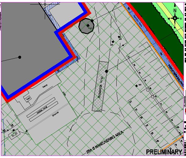

JIMMYD Posted November 13, 2013 Author Posted November 13, 2013 ok so ive followed those instructions and the drawing is now too big BUT i can make items out in the drawing, just only one section (see below) of the drawing?? As mentioned the drawing was before i arrived and my predecesor set to 1:500 @ A1 I forgot to mention in my last post that i have emasured the paper in 'paper space' is 841x594mm, which is perfect A1. J Quote
rkent Posted November 13, 2013 Posted November 13, 2013 (edited) Edit: So add a 2:1 scale following the instructions for doing that and then set that and see where you are. 2:1 in Meters would be 1:500 plotted scale. I had the first response in this post wrong so I updated the above, this should work for you. Edited November 13, 2013 by rkent Quote
eldon Posted November 13, 2013 Posted November 13, 2013 I would concentrate on the custom scale. Not all relevant scales are standard in AutoCAD. For drawings using metres as the unit, the custom scale = 1000 divided by required plot scale. In your first case of a scale of 1 to 625, 1000/625 = 1.6, which appears in the custom scale. For a required scale of 1 to 500, the custom scale would be 1000/500 = 2. Quote
