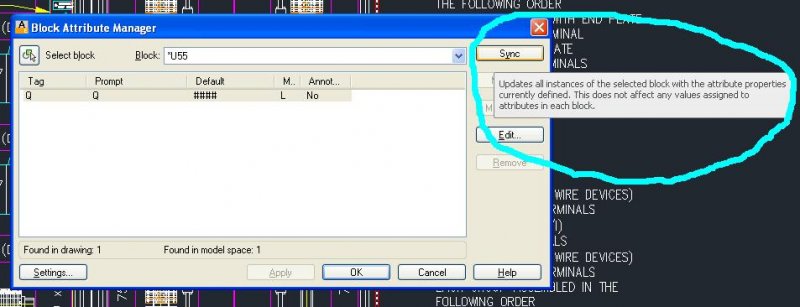

3. If you add or remove an attribute in a block that already exists in the drawing, that block will not update. You have to remove it and then add the new block with the attributes in it.
Not true. You need to ATTSYNC the block to add the attribute to ALL instances of the block. If you do not ATTSYNC only future blocks will have the correct definition.
Sorry, I didn't know that there was a command to update that. Thanks for the information. :)
I think you can use BATTMAN too but I've never used that command.
I think BATTMAN won't update, with that command you can choose the order of the attributes or change their texte,size and styles. I haven't played alot with it though.
But ATTSYNC is mostly useful.
as I said above, I've never used it but the dialogue box suggests that it will sync.
Now the only thing left to know is which one is faster to use :P
for me, ATTSYNC. My fingers can type that without thinking. I always leave one of the "T"s out of the other command expecting my favourite superhero to show up.
