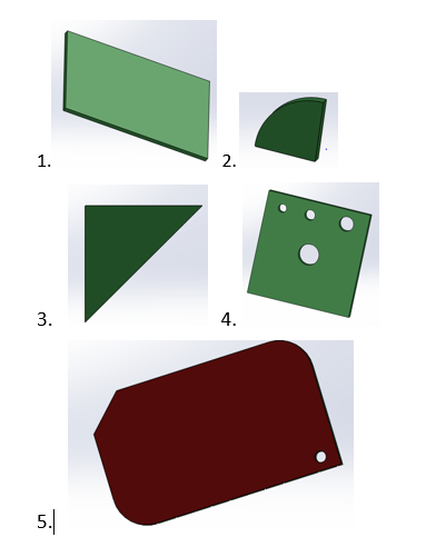

Hi all. I am looking to find out is there any program/system in place to satisfy what i want. basically i am looking for something where you have a pre made piece of material, say 100mm X 60mm 3mm acrylic.is ther any way you could have a drag and drop list of features like holes, fillets, chamfers that you could simply drop onto the piece to change how it looks. i made a quick diagram below. So basically 1. is the original piece 2.3 and 4 are possible features i could add to piece and i just want to add in featues like a corner radius and a hole etc.
Hope i am explaining right. thanks for any help

I don't know if it's what you are after, but for a simple and free 3D-program, I don't think you can beat Sketch-Up. I don't think it has the drag-n-drop that you are after - but it ain't much more complicated.

Looking at No 4, plate with holes yes it could be done would need a few clicks maybe use UCS with origin set to object so it gives dynamic x y as you move a circle then it just does the subtract for you.
If look at a 3d object, you would program wise
pick corner, set ucs, enter x off, y off, diam
Then extrude, and subtract done return ucs > world
You could have preset stuff like diameter, left hole v's central etc so dont do measurements to preset rules.
This sort of thing was asked for a long time ago to automate stainless bench designs I will try to find code its posted here. What I am trying to say it can be done but you have to set the rules.

Save this as a script say "test.scr" then just "script test"
rectang 0,0 100,100
extrude last  3
(setq obj1 (entlast))
circle 50,50 20
extrude last  5
(setq obj2 (entlast))
subtract !obj1  !obj2
vpoint 1,1,1
