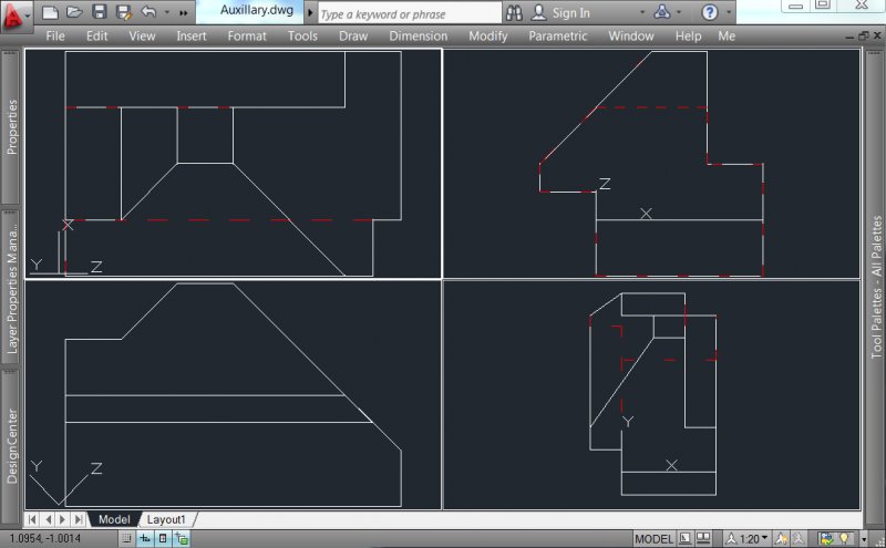

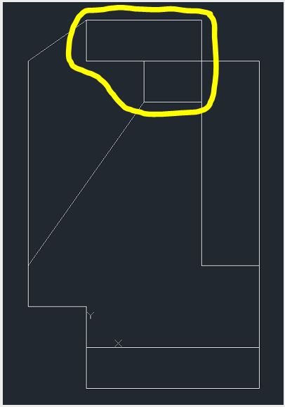

Autonoob24 Posted October 27, 2013 Posted October 27, 2013 I can't figure out what's wrong with my auxiliary view, any suggestions? http://imgur.com/a/HDrTc#0 Quote
ReMark Posted October 28, 2013 Posted October 28, 2013 (edited) Are you required to create a front view of the 3D object as if one was seeing it at an angle? If so what is the angle? 30 degrees? 45 degrees? Other? Are you also being required to create an isometric view? Edited October 28, 2013 by ReMark Quote

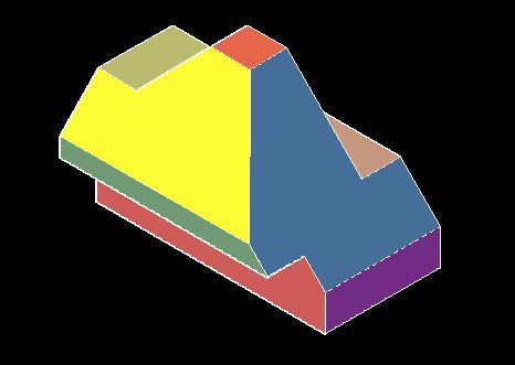

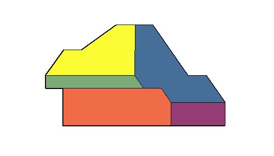

ReMark Posted October 28, 2013 Posted October 28, 2013 Here is a front view of your 3D object as if it were rotated 45 degrees to the right. Disclaimer: My version of your 3D object was done without the benefit of any dimensions and it should be considered an approximation only. Faces have been colored to aid in viewing. Quote
ReMark Posted October 28, 2013 Posted October 28, 2013 SE Isometric view of your 3D object. BTW...this image and the previous one utilize the Conceptual visual style. Once again I colored the faces to make viewing easier. Quote

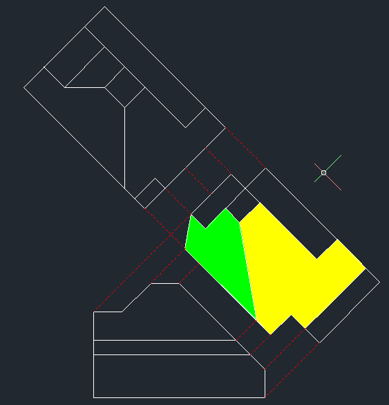

steven-g Posted October 28, 2013 Posted October 28, 2013 (edited) I get this as the auxillary view, giving the yellow section an area of Approx 10.5 and the green seen from the same angle an area of approx 4.5 EDIT - Ignore the areas I didn't notice the scale until post #9 below Edited October 28, 2013 by steven-g Quote
ReMark Posted October 28, 2013 Posted October 28, 2013 (edited) And how exactly did you arrive at that particular view? Did you look at the images in the OP's link? Edited October 28, 2013 by ReMark Quote
steven-g Posted October 28, 2013 Posted October 28, 2013 (edited) Drew the model and aligned the UCS to the face colored yellow as per the assignment request. It is my understanding that that is what the term auxillary view means. Because there are no sizes given I based the model on a footprint of 6x4 as per the grid and the area's are based on that. Edited October 28, 2013 by steven-g Quote

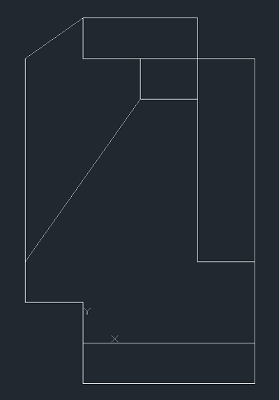

ReMark Posted October 28, 2013 Posted October 28, 2013 Re: View in bottom right hand corner. I don't see where the top left corner would be slanted nor do I see where the top right corner would be notched. What am I missing here besides my usual 10 cups of coffee? Never mind. I think I figured out how you came up with that view. Personally, I wouldn't think an instructor would ask for that particular view but until we get some feedback from the OP we don't really know for sure at this point. Quote
steven-g Posted October 28, 2013 Posted October 28, 2013 That is exactly what is asked for. And is the only simple way to answer the second question. PS I just noticed the scale of 0.2 inch per grid which will change the areas to approx. 0.4 and 0.2 respectively. Quote

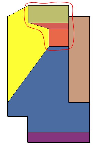

ReMark Posted October 28, 2013 Posted October 28, 2013 OK...after further thinking on it I'm having a problem with the area shown circled above. I think it is incorrect. Quote
ReMark Posted October 28, 2013 Posted October 28, 2013 I think that view should look more along these lines. Quote
steven-g Posted October 28, 2013 Posted October 28, 2013 Isn't your model in 3D, just set the UCS to the blue surface. The red and blue surfaces you have drawn are at 90 degrees to each other, so when you are viewing flat onto the blue surface all you will see is the edge of the red one. Quote

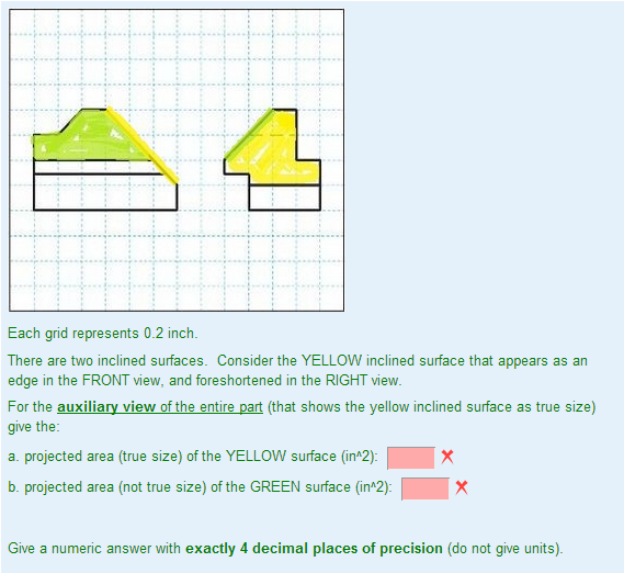

steven-g Posted October 28, 2013 Posted October 28, 2013 Post #9, there was a second page to the OP's original link, it could be a difference in how we are reading the meaning of the assignment, that's just what I made of it, and I originally missed the scale of the drawing when reading it. Quote

rkent Posted October 28, 2013 Posted October 28, 2013 Steve-g, I get exactly what you showed. Remark - I think you are not looking at the sloped surface perpendicular to it. Quote
Patrick Hughes Posted October 28, 2013 Posted October 28, 2013 It looks to me like the OP constructed the top view, then erroneously attempted to create the projected auxiliary view be merely rotating the top view. I haven't gone through the exercise myself but according to the second page he is to construct two aux views - one of the sloped face shown in the front view and one of the sloped face in the right view. Quote

steven-g Posted October 28, 2013 Posted October 28, 2013 (edited) ReMark/JD, I don't have the benefit of the book mentioned, I always thought an auxillary view was a view perpendicular to a selected surface, usually used to show details of a sloped or angled surface as in the example, but could be applied to any surface, so in theory you could have plan view or auxillary plan view. Patrick, The assignment only asks for one auxillary view, if we are guessing I would say the OP was trying to create the drawing by projecting perpendicular lines from the front view, which is the correct method to use in 2D draughting, the second question was to show the area of the front sloping face projected onto the first auxillary view, which the same drawing will give you. EDIT - Image added for clarity and answer the original question Edited October 28, 2013 by steven-g Quote
