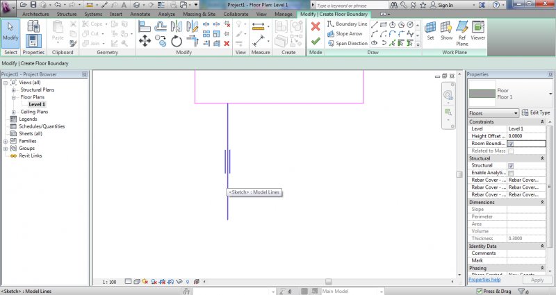

[Revit 2013 ]sketch line problem plz help me!!
hi , whenever i draw a line/square or anything .. i see this weird 2 lines between one of the lines i draw and i dont why .. like if iam drawing a couple of lines first line look like that the rest are not . .. if iam drawing a polygon one of the lines has to have those two short lines in between ... plz tell me how to fix that !

Those two lines is simply noting the Span Direction reference. So if you have a material applied to your floor that is striped linework, it'll display vertically or horizontally based on which reference you choose for the Span Direction. Read here:
http://help.autodesk.com/cloudhelp/2014/ENU/Revit/files/GUID-969E62BA-2A81-4557-A2F5-58842FCB590F.htm
You can change the Span Direction if you look at your Modify Ribbon, under Boundary Line and Slope Arrow.
