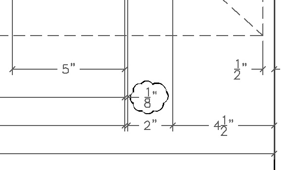

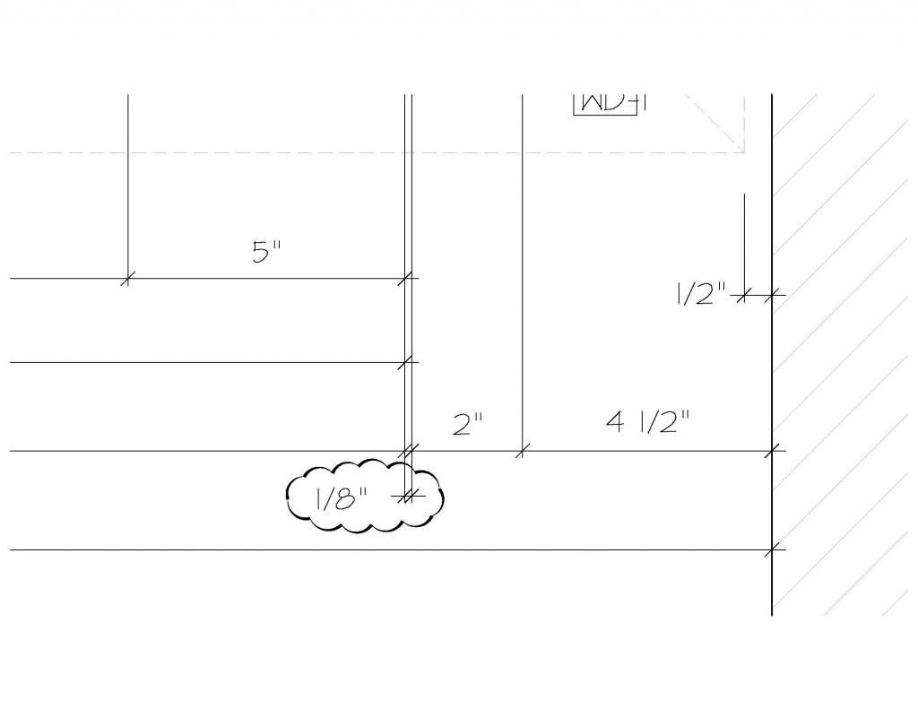

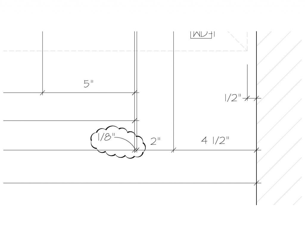

FLTLC Posted October 24, 2013 Posted October 24, 2013 Hi everyone, I'm currently having a debate within my drafting dept. as to which string of dims is more correct.....any input would be great.. The 1st pic with the dim that is pulled off the line, is viewed as sloppy and lazy. Your thoughts? Thanks! Quote

RobDraw Posted October 25, 2013 Posted October 25, 2013 I think sloppy and lazy are harsh terms to describe something as minor as that. That placement is wrong but I would find that terminology a bit extreme. Think about it. You've got a string of 100 dimensions and one of them is pulled out an inch from the others. Wouldn't you want to align with the other 99? Quote
Dana W Posted October 25, 2013 Posted October 25, 2013 The second image is the most common, and the most correct method. Every drafting class I have ever taken has taught it this way. The way the boss wants things done, whether correct or not, as long as it is legal, is the correct way. When one is laying out dimensions in several rows, along the same side of an object, having a bunch of them off line makes it hard to read. Don't argue that your example is only one line. Does one wear a shirt with one button undone in the middle of a run of buttons? Quote

f700es Posted October 25, 2013 Posted October 25, 2013 I agree with Dana in the 2nd option. I always show some type of leader when the dim text is pulled out of the string. Quote
Dana W Posted October 25, 2013 Posted October 25, 2013 I agree with Dana in the 2nd option. I always show some type of leader when the dim text is pulled out of the string.The main point is to never pull the dimension line out of the contiguous string. In Architectural drafting, there is a tiny bit of room for self expression, so it is acceptable, when the text won't fit between the extension lines, to either place the dimension text beside its extension lines if there is room, or if it is the end of a line of dimensions, and acceptable to place the text below or above the dimension line, with a leader. When I have to place dimension text above or below the dimension line, I usually try to get the leader (straight) to parallel the angle of the arch ticks, and bisect the space between them. Also, I match these dimension text items to the horizontal (or vertical) alignment of other dimension text items I have had to move in a similar manner, which are in the same string. If working in my shop, a draftsman would have to care about the appearance of the drawings as well as the accuracy. Drafting is part craft and part art. Aligning dimension text is not all about appearance. It is about ease of reading, and locating information by eye, quickly. If a drawing is all jumbled up, it is very difficult to read. Quote
Tuns Posted October 25, 2013 Posted October 25, 2013 The "proper" way is the way the guy/gal that signs the paycheck wants it and/or the client wants it. That is entirely wrong as there are such things as "industry standards" that by far trump company standards. The second option is clearly the correct way here. Separating it will only confuse someone else when they have to read it. Quote

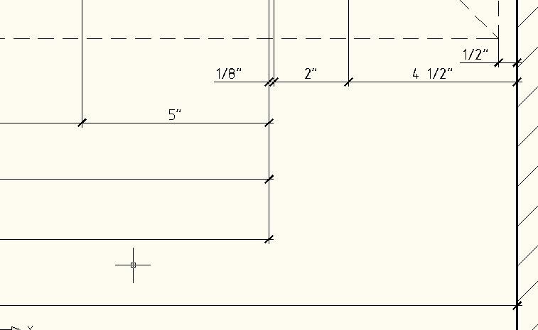

Organic Posted October 26, 2013 Posted October 26, 2013 I don't like how either of the pictures are done. The "1/8" should be below the dimension lines. Quote
Dana W Posted October 26, 2013 Posted October 26, 2013 I don't like how either of the pictures are done. The "1/8" should be below the dimension lines.The placement of the text is not as important as simply keeping the dimension line in alignment. The text goes where it fits, and in this example, you are correct in that it should be where it is less crowded up, below the dimension lines. Quote

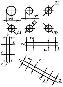

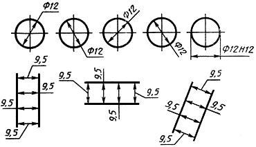

maratovich Posted October 26, 2013 Posted October 26, 2013 In our country, one standard for all. http://translate.google.ru/translate?hl=ru&sl=ru&tl=en&u=http%3A%2F%2Fdocs.cntd.ru%2Fdocument%2Fgost-2-307-68-eskd Quote
Dana W Posted October 26, 2013 Posted October 26, 2013 In our country, one standard for all. http://translate.google.ru/translate?hl=ru&sl=ru&tl=en&u=http%3A%2F%2Fdocs.cntd.ru%2Fdocument%2Fgost-2-307-68-eskd Yeah, I stopped reading at this line. 1. Developed and submitted to the Committee of Standards, Measures and Measuring Instruments under the USSR Council of Ministers Quote
