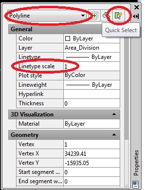

In another similar thread Robdraw recommended this: isolate the layer, select everything, and change the ltscale in the properties box. Or use QSelect to select all the affected lines.
There are another way to do it!
Select all objects, and in the properties box you can do a filter (quick select) by layer, color, type of object (line, circle, pline, arc), after the filter you can change the line properties in that box or with lts command!...
