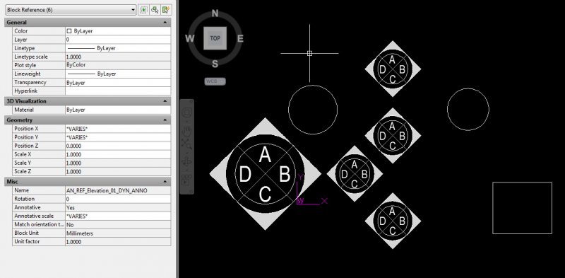

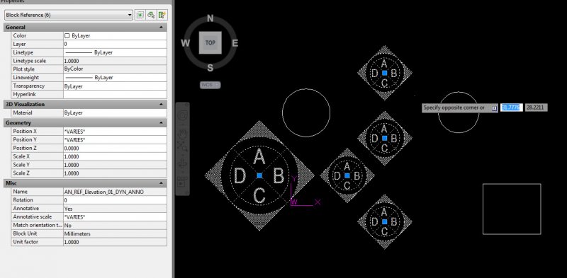

Thanks, I've done some more testing and it seems that it intermittently doesn't highlight the objects even though in the properties dialog it shows as been whatever number selected. Then if I click anywhere inside modelspace viewport they become selected. (See screen-shots attached). It's a minor bug but I'm sure I can live with that. I have done in the past with the old one but I thought you might want to know.
