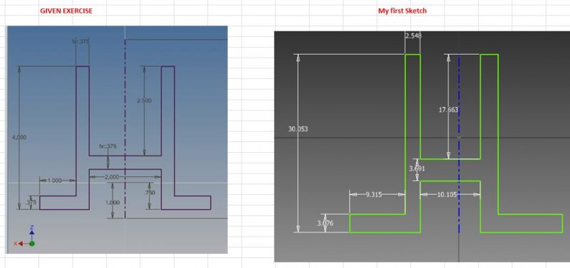

so when i started just rough sketch by ignoring the actual given dims, this is what i was told when using draw stuff on inventor i should draw it out first and apply the constrain later. when i finished the sketch in large scale as shown on the first pic (called"my first sketch") and then when i applied on 4 the constrain to match with the given dims the geometry shape look very strange as the very bottom pic. Do your guys have special rule of constrain? why don't we draw in the actual given dims at the first place in Inventor just like in Autocad? when i was told to use STANDARD.ipt, is it in metric or English unit? i don't have anything on my Inventor that said Standard.ipt?

.... i was told when using draw stuff on inventor i should draw it out first
You were told wrong.
Sketch ONE line, rectangle or circle and dimension it immediately to give a sense of scale for the rest of the sketch (this was fixed in later releases of Inventor). Read this http://home.pct.edu/~jmather/SkillsUSA%20University.pdf

Thank you, i found the Standard.ipt now, it was in different tab. And the geometry looks much better now by using your suggestion "Sketch ONE line, rectangle or circle and dimension it immediately to give a sense of scale for the rest of the sketch ",
