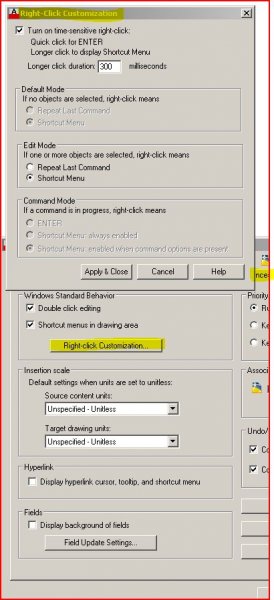

I have never used the Sheet Set functionality, but it occurs to me that
the problem you are having might be symptomatic and driven by another
setting. I favor time sensitive right clicking, and wondered how your right click preferences might be configured, and whether
or not those settings might be exacorbating this issue.
Have you tried doing this with your Dynamic Input turned off?
That might help.

Thank you sir Dadgad! I definitely am going to try that. I never knew there were settings for right click in autocad. That's new info to me. I'll update this thread with any effect that might cause. Thanks again kind sir!

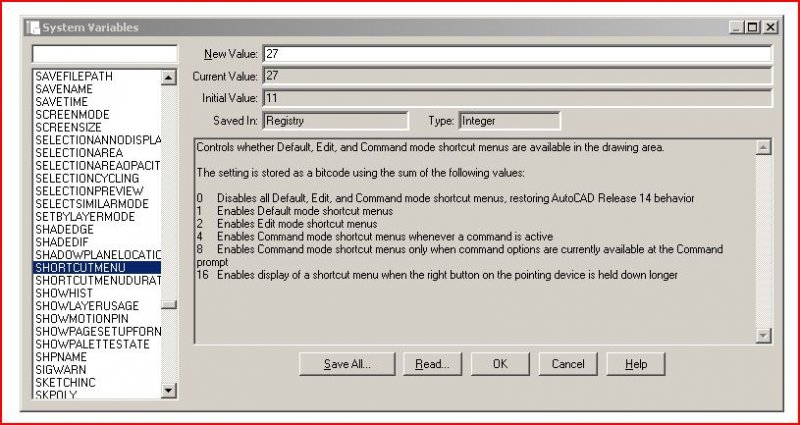

Given that you were not aware of the option,
your settings are likely the default ones, and so this may not be a contributing factor.
In OPTIONS, you can click on the USER PREFERENCES tab, as shown to access some of the options
available through the SHORTCUTMENU system variable.
I have added a clipping of the SYSVDLG description of this system variable optional settings.
The SHORTCUTMENUDURATION system variable is the one controlling the time sensitive right click setting.
Remember to try with your DYNAMIC INPUT turned off, as that might be the fly in this particular ointment.
Good luck, hope that helps you.

after a minute of searching for that "right click customization" box, i found it and tried checking "turn on time sensitive right click" (it was unchecked). it did not really solve the problem, but what's surprising is that after checking it, the "success" rate of making the scalelist show by right clicking grew from 10% to like 80%. but like before, sometimes it wont. but not as much annoying and frustrating as before.
I tried unchecking it again and it's still at around 80% success rate (which is so much better than before). i tried turning autocad on and off. and it seems that messing with this setting just makes the headache lighter but does not really solve it. i still have no definite idea what's going on with this problem. checking/unchecking the time sensitive right click seems to help lower the frustration rate. So it does not really solve it. I don't know why, or how, but it does help A LOT. It's not the fix but it almost is. There are times i just want to punch the screen/throw the mouse through the window out of frustration. But now it just takes me 3 tries (max) before i get the scales list to show. sometimes i get it with just one click. So big big thanks Mr. Dadgad for the response. Not even mastering autocad 2014 has a solution for this. (great book anyway. i learned autocad just with this book. very helpful!)
I still hope someone will share a definite fix for this problem. Still thank you Mr. Dadgad. You just saved me (and other few people who might be experiencing this same poblem) precious time and patience! God bless you sir!
btw i also tried turning on/off the dynamic input but it doesn't make a difference any more than what the "turn on time-sensitive right click" did. but still, im very happy with how it responds now. so thanks again!
