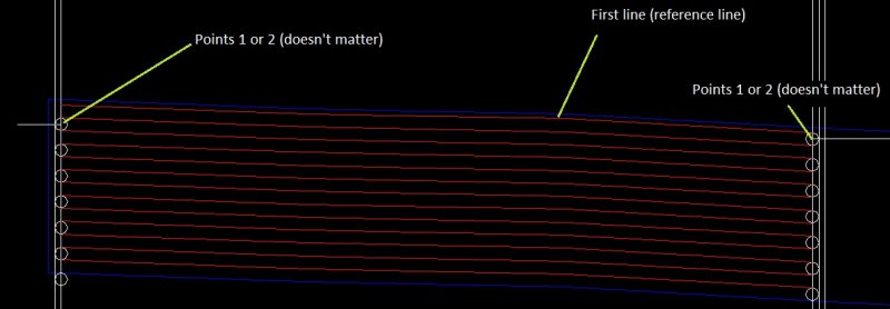

Attached lisp file replaced due to the lack of (command) function vs (entmake) function... Now posted lisp should correctly work and on versions
Also, no matter that it's called snakefill-2linesboundaries-arc, it can be applied and on 2 curve boundaries as long as reference arc (half circle) would make intersections while copy-moving along horizontal/vertical curve boundaries...

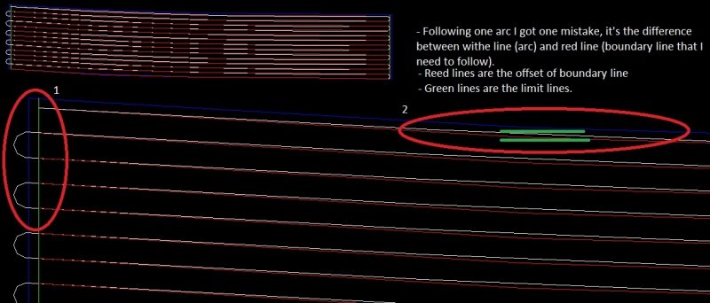

Marko_ribar It's working!... I did some tests and I'm showing to you the result on the picture... I don't know, but, because the arc is so big to try to follow the boundary line, it could cause the situation 1. Also, following a arc as a reference line I miss a little distance of boundary line the situation 2... The boundary lines aren't a perfect lines as a arc, because it, I asked if it's possible to choose a pline to follow instead of a arc...
Grateful...
Marko_ribar,
As I told you, I'm trying to do it in the worst way!... :( But, is a good beginning to someone that is newbie in this kind of code!... I guess!...
Thanks again...
