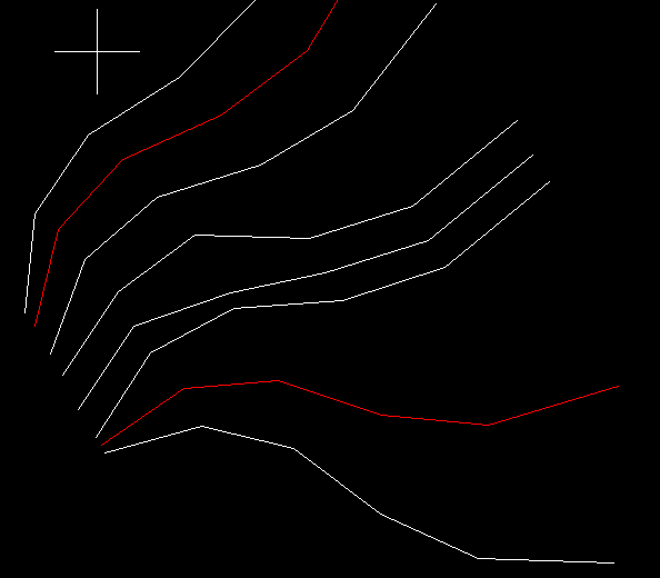

Here's another concept to play with:
(defun c:sample ( / a b e i l p q s v x z )
   (if
       (and
           (setq p (getpoint "\nSpecify 1st point: "))
           (setq q (getpoint "\nSpecify 2nd point: " p))
           (setq s (ssget "_F" (list p q) '((0 . "LWPOLYLINE"))))
           (repeat (setq i (sslength s))
               (setq e (entget (ssname s (setq i (1- i))))
                     z (cdr (assoc 38 e))
                     v (mapcar 'cdr (vl-remove-if-not '(lambda ( x ) (= 10 (car x))) e))
                     l
                   (append l
                       (vl-remove nil
                           (mapcar
                              '(lambda ( a b / x )
                                   (if (setq x (inters p q a b))
                                       (list (car x) (cadr x) z)
                               v (cdr v)
           (entmake '((0 . "POLYLINE") (70 . ))
           (foreach x
               (vl-sort l
                   (function
                       (lambda ( a b )
                           (<  (distance p (list (car a) (cadr a)))
                               (distance p (list (car b) (cadr b)))
               (entmake (list '(0 . "VERTEX") '(70 . 32) (cons 10 x)))
           (setq p (cdr (assoc 330 (entget (entmakex '((0 . "SEQEND")))))))
           (while (/= 5 (car (setq x (grread t 13 0)))))
           (setq x (vlax-curve-getclosestpointtoprojection p (cadr x) '(0.0 0.0 1.0)))
           (setq e
               (cons -1
                   (entmakex
                       (list
                          '(0 . "TEXT")
                          '(72 . 1)
                          '(73 . 2)
                           (cons 10 x)
                           (cons 11 x)
                           (cons 40 (getvar 'textsize))
                           (cons 01 (rtos (last x)))
           (while (= 5 (car (setq x (grread t 13 0))))
               (if (setq x (vlax-curve-getclosestpointtoprojection p (cadr x) '(0.0 0.0 1.0)))
                   (entmod (list e (cons 11 x) (cons 1 (rtos (last x)))))
(vl-load-com) (princ)

pBe and Lee Mac nice try. Is it possible to have the osnap on because some times i have same specific points and i need to calculate the elevetion there.
pbe what about this problem .... can you fix it ? :)

Unfortunately Object Snap (and indeed, all other standard drawing aids such as Orthomode, Tracking etc.) is not available when using a grread loop to monitor user input; the posted program is more of a concept program to share an idea and would probably be impractical for commercial use due to the lack of Object Snap.

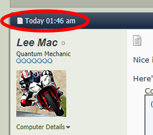

  GP_ said:
...by night? :D :)
BST here (GMT+01:00) so 12:46am, but yes, can't sleep when I have an idea for a program...
