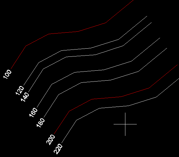

Hi to everyone
Does anyone have or know of a LISP application that
will making the selection of a group of level lines, it is possible to click freely among them, and the application calculates (and writes in the drawing) the height by interpolation of the two pairs of points closer to the adjacent level curves.
- select Pair of points (two texts) and calculate the beween elevetions (photo1)
- select level lines (polilynes with angle of inclination) and calculate the beween elevetions (photo2)
Thanks

You're looking for a lisp routine that will calculate and input a spot elevation based upon a random point you select that falls between two contours. Does that accurately describe it?
I need a lisp to do two things
1) if i have two points with elevetion text click the first elevetion text then the second elevetion text and when i click between them like the (photo 1) to caclulate the elevetion and write the text
2) if i have contours (polylines ith elevetion) to select them all and when i pick to any point writes me the correct elevetion
Is it possible?
I believe the first one could be done but I don't know about the second.
Is it possible?
I believe the same logic applies to both, for number 1) are the points elevated to correspond with the text value? are these attribute values? [bTW, i dont see any point entity on the snapshot], for number 2), yes, but whats confusing is the "select them all" part, or do you mean two at a time regardless if its adjacent to each other or not?
1) From the first (Pick the endpoints of the line)
2) I don't know what is possible (to select them all or two at a time)

To write an effective code you need the distance between two points. so can we assume if it is indeed the text entity the "point" will be the insertion point?
How about posting a sample drawing file to clear the confusion.
Edited by pBe
  prodromosm said:
Here is a sample drawing :)
Here is a simple code for item number 1. Not sure it'll work as you wanted>

Nice try but i think that the calculation is wrong. Can you do something for the second part.
I see, show me the correct value if i select the middle of the line? 150.20?
I see why.i'm guessing ts a TEXT alignment point/Insertion point issue. changing 10 to 11 is the quick fix.
Code at post #10 updated
Edited by pBe
With the yellow collor is your results. Some calculations are the same with mine but same other are difference.I add some red points to speak about specific position
contous2.dwgFetching info...
Edited by prodromosm
Update code at post # 10
:beer: nice job pBe thanx.The first part of my question is complete.....

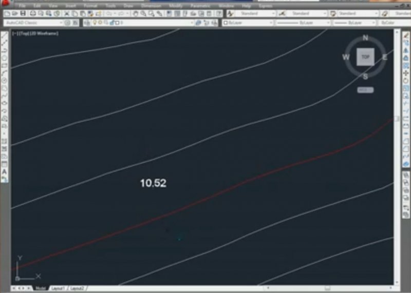

Item number 2: based on your example. "elevation" between contor 1 and contour 2 you have 110.8, automating the process can be quite tricky . if i to write a code i will determine half the distance between contour lines which makes a dead even 110.00. and so on. Now if you add an option to indicate a "distance from" or divide the space by # then we can proceed to do that. IF you are wanting to pick a point between each contour at every interval, that will give the distance per level, is that how you wanted it to work for you?
Edited by pBe
This is my attempt for item number 2.
Does not always work.
Here it works.
Here it does not work.:P
(defun c:test ( / p1 p2 d sel LEV LEV_F LEV_L TT)
