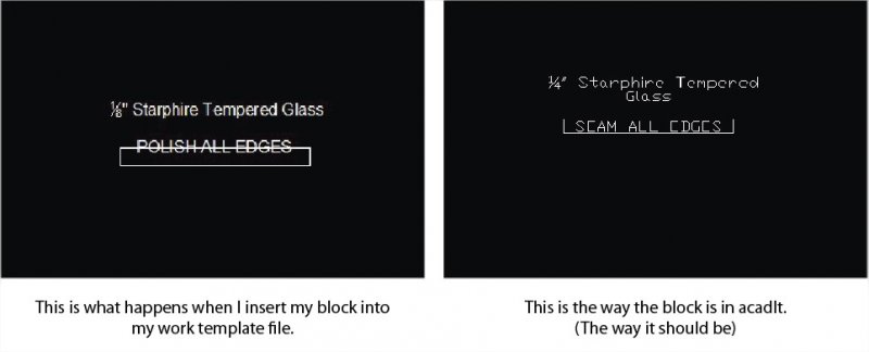

I have been working on blocks to help improve our production drawings at work. I created the blocks in the default template acadlt and it works fine, but if I import it into my work template the block doesn't import correctly. My work template file can be found on this link http://www.cadtutor.net/forum/showthread.php?79175-I-d-like-some-constructive-criticism (Its my bosses Thread). I will post images to show you what the block does when inserted please help.
Here is an image of my problem.
Check your textstyle "STYLES" they both use one common style but the actual typface is different in the two dwg's say Arial v's Iso
Thanks That was the problem your a big help
