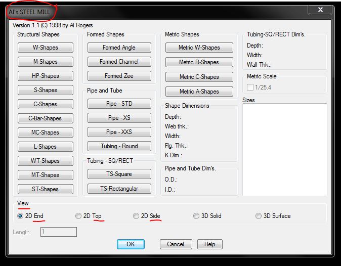

I'm trying to work on a code where I can project the Top and Side views from a cross-section of a W-Beam (see attached block for an example).
I've tried my best but this is as far as I got before spinning my wheels.

You did not search thoroughly enough. What you need is Al's Steel Mill. Check this out...
Ta da! Do I have your attention now?
