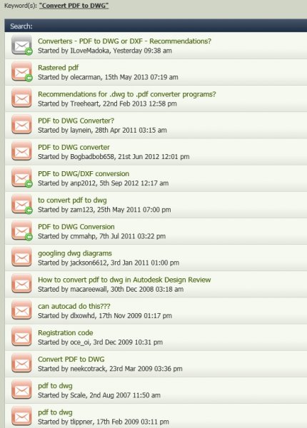

ILoveMadoka Posted October 15, 2013 Author Posted October 15, 2013 I searched "Convert PDF to DWG" After getting spanked I searched again and I did find it, 3 pages in. I thought my search terms were pretty specific. Specific enough that after 2 pages filled with results I thought a new thread wouldn't kill anyone.. Why the first thread that I thought applied to my search was 3 pages deep I don't understand. I guess I will have to always use the ADVANCED search. Thanks anyway...
SLW210 Posted October 15, 2013 Posted October 15, 2013 (edited) I bring up a few threads in a search. Edited October 16, 2013 by SLW210

SLW210 Posted October 16, 2013 Posted October 16, 2013 First we need to know if it is Raster or Vector PDFs or both. I use Illustrator and VectPDF, usually get ok results and saves time usually depending on original file. Rasters, I usually just trace or redraw from scratch. Here is an RSS from CAD Panacea for an online FREE tool. A search "Convert PDF to DWG" with the Quotes will return 2 pages of
