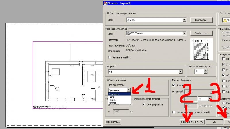

maratovich Posted October 11, 2013 Posted October 11, 2013 cyril_13 For creation of viewports it is possible to use lisp. Lisp is enclosed. vplo.lsp How to use lisp it is specified in video: In your drawing of a problem with Hatch. When printing because of Hatch there is very long regeneration of drawing: If you have many such files, you can send them to me on a mail. I will keep quickly them in.pdf Only the polyline should transfer to Defpoints layer. I will do so: P.S. cyril_13 you from what country? vplo.lsp Quote

maratovich Posted October 14, 2013 Posted October 14, 2013 You have set the print area - the window. You need to set - the border. Quote
cyril_13 Posted October 14, 2013 Author Posted October 14, 2013 ah, okok.. As I don't have the menues in Russian, I chose the wrong option. Thanks. I'll continue the video then. Quote
maratovich Posted October 14, 2013 Posted October 14, 2013 ah, okok.. As I don't have the menues in Russian, I chose the wrong option. Thanks. I'll continue the video then. And I do not have the English AutoCAD Quote
ReMark Posted October 14, 2013 Posted October 14, 2013 Since a numbered image was provided one does not need to know how to read Russian to understand the steps maratovich wants you to use. Quote

maratovich Posted October 15, 2013 Posted October 15, 2013 Do I have to select the layout print properties for each layout ou can I copy/paste the plotting options: scale to paper, center plot.. ? I ask you to write short phrases. At first it is necessary to establish all settings of 1 layout. Then to press the button - to apply to layout. And then to copy this leaf. And then to create viewports I guess it's not possible to "select" multiple layouts and have them printed at once..? For this purpose it is necessary to use Publish In your second video, if I get it right, you're printing places based on their geographic position. The program looks for polylines. On coordinates of polylines printing is made. Polylines can be different and are in any place of drawing. What is the software you're using ? (didn't find anything for "PEBPC" or the russian version "реверс").Is it part of Autocad ? Russian name "PEBEPC". English "REVERS" (as reversive movement on the highway) Program site -http://www.kdm-info.narod.ru/revers.html This external addition to AutoCAD. I warn - in English Windows it wasn't tested. If it is required to you I can remake into English. By the way, what is the meaning of the red arrows on your drawing above ? When printing very long regeneration. If to remove that is specified by shooters, printing fast. The mistake means in this primitive. You have a filling by color. It is necessary to use usual HATCH. ( command _HATCH) Quote
