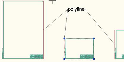

If the edge of drawings is made polylines, probably it needs this decision.

The program looks for polylines.
Compares with necessary of the set list.
Receives coordinates of points of the necessary polylines.
Establishes a printer name, a paper format, style.
Prints a frame on polyline coordinates.
