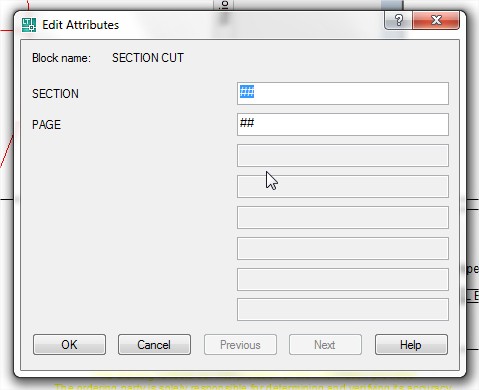

I guess you want her to learn Block Attributes.
Is that what this is called? I forget:
That's the best way honestly. I learned how to do these blocks by looking at what Steven and Mwade posted here. I'm the only one at this company that actually knows how to do any of these things so there really wasn't any other way to learn how. Don't forget to teach macro's and Diesel too. :)
