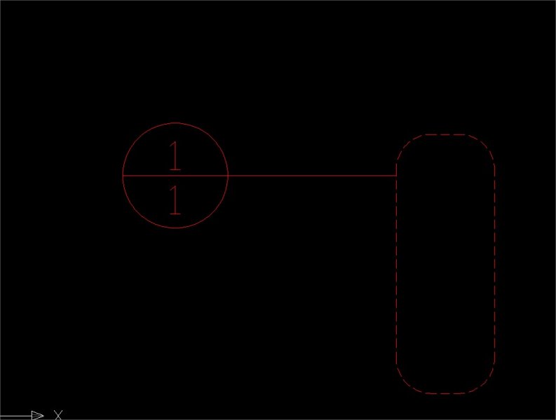

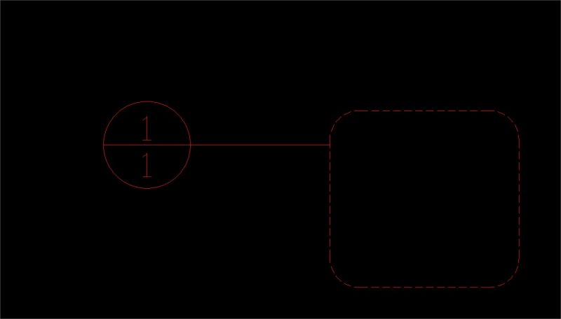

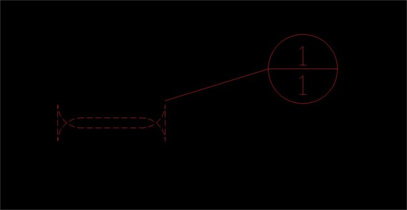

vpatterson Posted October 8, 2013 Author Posted October 8, 2013 Ok well I am sorry I cant upload the updated dwg from my work computer. They wont allow it (my work). here are some jpegs I know they are hard to see I am sorry best I can do till boss comes back. Quote
vpatterson Posted October 8, 2013 Author Posted October 8, 2013 top and bottom is what I want it to do middle is what I do not want it to do. and also if you stretch it enough the bubble detaches its self from the block? does anyone know why? Quote
steven-g Posted October 9, 2013 Posted October 9, 2013 top and bottom is what I want it to do middle is what I do not want it to do. and also if you stretch it enough the bubble detaches its self from the block? does anyone know why?We could keep on trying to guess but really we need a bit more info on what exactly should stretch/scale/rotate, or maybe a few sketches showing the various options Quote
