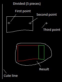

First step
If you want to split your polygon to 5 pieces you will choose DIVIDE
if you want to split your polygon to pieces with specific area in (sq.m) you will sellect CUT
Second step
You have to choose PARALLEL line ,(far far far from lwpoly), this is the key be carefull
I use it in any area .
One tip for faster DIVIDE
If you choose as good as possible the nearest plase to put the parallel line the lisp will do faster the divide.
If you don't mind, I've modified the code to better suit prompting and little mistake with PARALLEL option (offsetting point was wrong)...
M.R.
Marko_ribar, thanks about the code, but, I don't know what's going on, I'm trying to split one area, so, the picture below show you the result, I'm doing some thing wrong?...
Thanks again...
Nothing wrong, you picked points correctly... Split area is in green - it's 1/5 of major area... To split it from left to right, you must create cut line on the right and pick points from right to left (the same way you did from left to right)... Then you repeat step, but you select red pline and type 4 pieces, and so on... 3 pieces, 2 pieces and that's it - all area is split by 5 pieces with relatively correct areas...
Hummm... Thanks a lot Marko_ribar!... It's working!!!... I was waiting to split it on 5 pieces at same time!...

;;;          is imaginary, you MUST NOT draw it, let the routine draw it,
;;;          just indicate its endpoints
;;;          (you may have to draw auxilliary entities BEFORE you start DIVAREA)
;;;     3. Bear in mind that this DIVISION LINE will be rotated (or be offseted) and
;;;         neither of its endpoints should be inside the boundary, at
;;;         any moment, or else the result will be unexpected.
;;;     4. An easy way to help things going, is to indicate the two
;;;         end-points as FAR OUT from the boundary as possible, not exceeding
;;;         of course, your current visibe area.
;;;     5. The only exception is for the FIXED POINT, in case that
;;;          you prefer "F" rather than "C" as an answer in the relevant question.
;;;          Fixed point must be ON or OUTSIDE the polyline, NEVER INSIDE.
;;;     6. Next, pick a point into the part which will obtain the desired
;;;         area. You have to indicate INTO it, NOT ON the boundary and AS FAR
;;;         from division line as possible, so this point will not be outside of
;;;         the desired part while the division line is moving towards the point.
;;;     7. Finally, you have to indicate the remaining part, exactly
;;;          by the same way, FAR FROM DIVISION line and INTO the remaining piece.
;;;     8. For better area approximation you can decrease local vars
;;;         stp2 and stp1 in the following program-lines accordingly.

  • 2 years later...
My results in AutoCAD Civil3d:
Command: PL PLINE
Specify start point:
Current line-width is 0.0000
Specify next point or [Arc/Halfwidth/Length/Undo/Width]:
Specify next point or [Arc/Close/Halfwidth/Length/Undo/Width]:
Specify next point or [Arc/Close/Halfwidth/Length/Undo/Width]: c
Command: DIVAREA
Select a CLOSED polyline :
SORRY, ONLY CLOSED POLYLINES ALLOWED...nil
Actual : nil
Must be: nil
Thanks...
Now tell me what did i do wrong?
Ow... and how can i turn the blips off, after DIVAREA is done?
Found the blipmode...:
.BLIPMODE
Command: .BLIPMODE
Enter mode [ON/OFF] : off

Good day. Bigal, thank you very much for your interest. In the following code I indicate which are the lines that you add, in blue. Thanks, again

(defun C:DVA (/
   OSM    STRPF    STRDC    EX    STEP    ARXSET    ARX    ARXON
   K    OK    D    P1    P2    PTS    PTB    DELN    AR    PAR
   TEM    PJ1    PJ2    PJ1X    PJ2X    PJ1Y    PJ2Y    DISX
   DISY    PJN    PTSS    PTBB    DIST    DELNJ    DELN1    LINEAD)
 (setvar "osmode" 0)
 (setvar "cmdecho" 0)
[color=blue]  (setq vcs 1) (setq k 1)[/color]
 (setq OLDERR *error*
   *error* PRERR
   OSM (getvar "osmode")
   STEP 10
   EX 0
   ARXSET (entsel
     "\nSeleccione una LWPOLYLINE cerrada como perímetro del área a dividir: ")
   ARX (entget (car ARXSET))
   ARXON (cdr (assoc -1 ARX)))
 (if (not
     (and (equal (cdr (assoc 0 ARX)) "LWPOLYLINE") (= (cdr (assoc 70 ARX)) 1)))
     (princ "\nDISCULPE, SOLO SE PERMITEN LWPOLYLINES CERRADAS...")
     (setq EX 1)))
 (if (= EX 0)
     (command "_undo" "m" "_layer" "m" "Area_Division" "" "_area" "e" ARXON)
     (setq AR (getvar "area"))
     (initget "Divide Cut")
     (setq STRDC (getkword
         "\nDIVIDE por número de partes o [CORTA una superficie conocida]? (D/C): "))
     (if (= STRDC "Divide")
       (setq K (getreal "\nIntroduzca número por el que dividir el total: ")
         TEM (/ AR K)))
     (if (= STRDC "Cut")
      [color=blue] (progn
       (setq vcs 0)[/color]
       (setq TEM (getreal "\nIntroduzca el área a cortar del total (m2): "))
       [color=blue])[/color]
     (initget "Parallel Fixed")
     (setq STRPF (getkword
         "\nLínea de corte PARALELA a una dirección o [por un polo FIJO]? (P/F) :"))
     (if (= STRPF "Fixed") (FIXPT))
     (if (= STRPF "Parallel") (PARPT))))

[color=blue]  (while (< vcs k)
 (LINEA)[/color]
 (setvar "osmode" OSM)
 (setvar "osmode" 0)
 (command "_line" P1 P2 "")
 (setq DELN (entlast)
   PTS (getpoint
     "\nEscoja un punto DENTRO de la porción a obtener y ALEJADO de la línea divisoria: ")
   PTB (getpoint
     "\nEscoja cualquier punto del RESTO del área y ALEJADO de la línea divisoria: "))
 (setvar "blipmode" 0)
 (princ "\nPor favor, espere...")
 (setq PTSS PTS PTBB PTB)
 (command "_boundary" PTS "" "_area" "e" "l")
 (setq PAR (getvar "area") OK (if (< PAR TEM) 1 (if (> PAR TEM) -1 0)))
   (while (/= OK 0) (SUPERIORP) (INFERIORP))
   (entdel DELN))
 (command
   "_change" "l" "" "p" "c" "green" ""
   "_boundary" PTBB ""
   "_change" "l" "" "p" "c" "red" "")
[color=blue]  (setq vcs (+ vcs 1))
 )[/color]

Hi .I know that this post is old but i need to ask if someone can update the code and add and extra optionto divide into 2 or more parts  with a user line option
like this
Thanks
Edited by prodromosm
