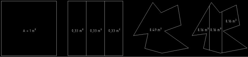

CafeJr Posted October 7, 2013 Posted October 7, 2013 Hello, I need one help to do a LISP that can execute it: get one irregular area, and split it according a specific aredea defined, like, 100 m², and I need to split it in 25 m² (I know that it will result on 4 parts of the first one, but how do it?), can someone help me, thanks a lot. José Robeto. Quote

CafeJr Posted October 8, 2013 Author Posted October 8, 2013 wow. good luck. if any curves at all i would imagine you would need some Calculus to obtain the required area? unless taking chunks out of the middle somehow. I need something like the picture, is necessary to split the area independently of the form... Thanks for help... Quote

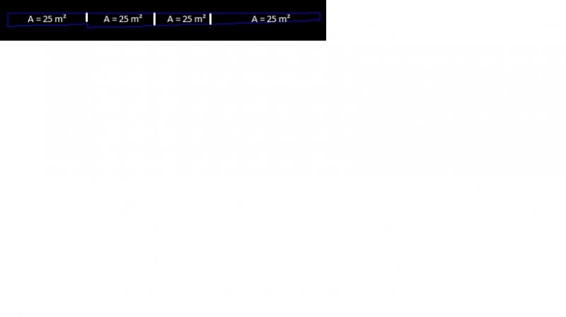

CafeJr Posted October 9, 2013 Author Posted October 9, 2013 (edited) Sorry Organic, so, that Lisp on your link split a region as the picture (in two pieces), so what I'm looking is one Lisp that can get the total area and divide it by a specific area or specific number of pieces. To do it with a regular area it's easy and do not necessary a Lisp, so to do it with one irregular area it's necessary something to help, I'm ataching another picture as a example and one link: Something like that: Edited October 10, 2013 by CafeJr Quote

BIGAL Posted October 10, 2013 Posted October 10, 2013 Re the pictures to split a object into 3 you would run the routine twice and nominate the area required each time. It could be modified to recognise total area and work it out for you. Do a bit of googling using "survey" as one of the key words if you can find theory then someone can do coding. Quote

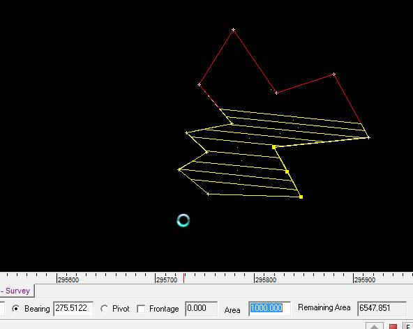

BIGAL Posted October 10, 2013 Posted October 10, 2013 This is a screen grab of a commercial product (Civilcad) you can see the lots being produced it has various options on how to create a lot but you do have to buy it. Quote

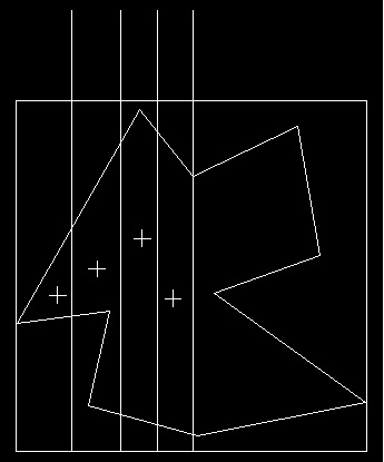

CafeJr Posted October 11, 2013 Author Posted October 11, 2013 "Bigal", It's exactly that I need, but to apply on AutoCad 2010... I'm looking for it a litle time and studing how to do the Lisp code, so it's no too easy... cause the references points that's necessary to get and how to split these area... I'm trying to create a "map" like a knowed are above the area that I'm spliting and after work like a manually through trial and error, drawing a line get the area inside, check, and erase the line if's out of the wanted area and drawing another line again to find the wanted area... Thanks to help... Quote
